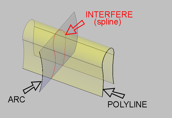

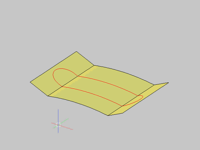

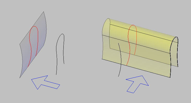

JD Mather Posted September 9, 2014 Posted September 9, 2014 I didn't open your file - but someone else posted a similar problem in the past several months. You can now project one curve onto another, so if you create 2D curve from front view and 2D curve from side view - you project these two curves to their 3D intersection curve to use as a Sweep path. Quote

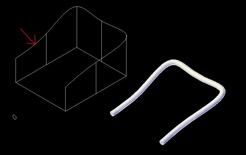

ReMark Posted September 10, 2014 Posted September 10, 2014 You might be able to do it using a spline. Quote
bgkeh Posted September 10, 2014 Author Posted September 10, 2014 hurmm... using splines only curving it on the xy plane, the one from the picture is what i called 3d spline (i dont know what it is called). Quote
ReMark Posted September 10, 2014 Posted September 10, 2014 I don't think splines care. I see no reason why a spline could not be used. See the red arrow? It is pointing at a spline. The circle was extruded along the spline. This was done in 3D. Quote
ReMark Posted September 10, 2014 Posted September 10, 2014 This was done using splines along with the Sweep command and two circles. I did not draw the spline centerlines. Quote
bgkeh Posted September 10, 2014 Author Posted September 10, 2014 I don't think splines care. I see no reason why a spline could not be used.[ATTACH=CONFIG]50832[/ATTACH] See the red arrow? It is pointing at a spline. The circle was extruded along the spline. This was done in 3D. ahaaa, this method i already have in mind, placing a lot of points and connect it with a spline. [ATTACH=CONFIG]50833[/ATTACH]This was done using splines along with the Sweep command and two circles. I did not draw the spline centerlines. but this one, how did you do it? mind teaching me the steps? or did you do it using the above's method? thankss Quote
ReMark Posted September 11, 2014 Posted September 11, 2014 As I mentioned in post #11 I did not draw the spline centerline. I imagine it was done similar to what I demonstrated but I can't say that with 100% certainty. I can think of at least one other way it might be done without using splines but it would be rather involved. Quote

ReMark Posted September 11, 2014 Posted September 11, 2014 Well there are many ways to accomplish a task in AutoCAD. Your job is to find the one that works best for you. What do you mean you aren't "sure AutoCAD can make the curve as reference curve"? If you don't know what you are talking about then there is a good chance we don't either. Try a different approach. Don't give up though. Failure still teaches us something. JDM mentioned another approach but did not provide a link to the appropriate thread. Maybe someone else remembers the thread and can post a link to it. Just be patient. Quote
ReMark Posted September 11, 2014 Posted September 11, 2014 I think I may have found the thread that JDM was referring to. http://www.cadtutor.net/forum/showthread.php?87449-Problem-drawing-3D-object I've yet to read through it all but when I do I'll try to point out the relative part. I'll be back. OK...I'm back. Look at posts #11, 14, 19 and 22 as they should provide you with the necessary information. Good luck. Quote
