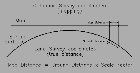

eldon Posted September 8, 2014 Posted September 8, 2014 As you are drawing this exercise in AutoCAD, you can probably dispense with the Scale Factor. I mentioned it because not a lot of people know about it, and completely ignore the fact that a distance measured on a plan (or drawing) with UTM coordinates, is not the same as a distance measured with a tape on the ground's surface between the same two points. Quote

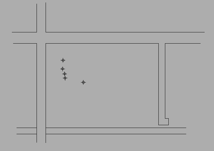

eldon Posted September 10, 2014 Posted September 10, 2014 Ah, a geologist. He probably did his surveying by pacing out the distances on a compass bearing!!! I expect you will end up with something almost like this. Quote
Zigster Posted September 10, 2014 Author Posted September 10, 2014 Yeah he's pretty old school. Also, I feel like this is a really stupid question, but did you draw those symbols yourself or do you insert them from some standard library? Quote
eldon Posted September 10, 2014 Posted September 10, 2014 Those symbols are one of the standard AutoCAD points. Look at the Point Style. Quote

Ibrahimed Posted July 9, 2020 Posted July 9, 2020 I really have a lot of questions in mind and would really need help 1. I'm using AutoCAD 07 on my system and longitude and latitude ordinates are not in use, how can I convert utm ordinates to long. And lat. 2. I want to talk how the point of view that the earth is spherical in shape, how does the spericity of the earth affect the utm coordinates since all forms of geo-standards talk about the position of each point on earth surface in space as Eldon explained in the place U said actual measurement on earth surface is a multiplier of utm ordinates distance? Thank you. Quote
