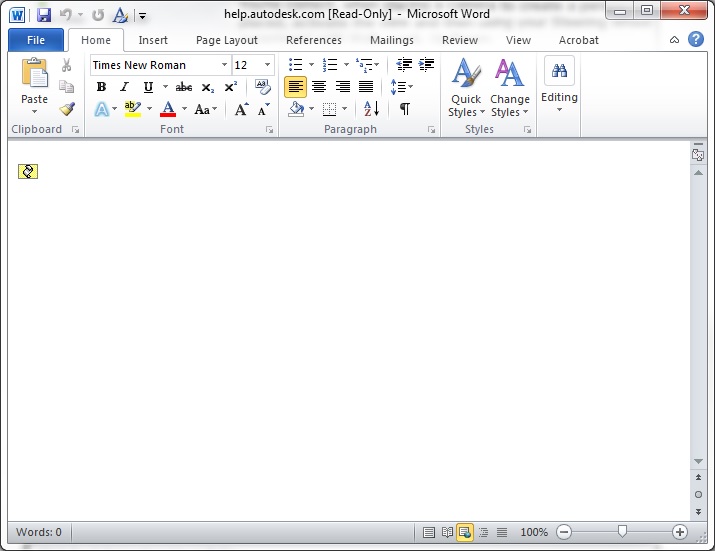

This is an odd one.
Pressing F1 for help in Revit opens up a blank Word document, with a tiny scroll image in the top left corner. This document is entirely useless and the image is not hyperlinked.
I know this is quite vague so any questions and I'll answer as best I can. :ouch:
I'll see if I can get an image of it.

Here's the image of it... hopefully.
Your pc is trying to open a html file using MS Word.
You need to change that and should work fine
go to control panel, Default programs, set your default program
or go to C:\Program Files\Autodesk\Revit 2014\Help\en-US\WBH\index.html right click on index.html , open with, choose default program and pick internet explore (for example), make sure the box that says "always......." is ticked and OK
