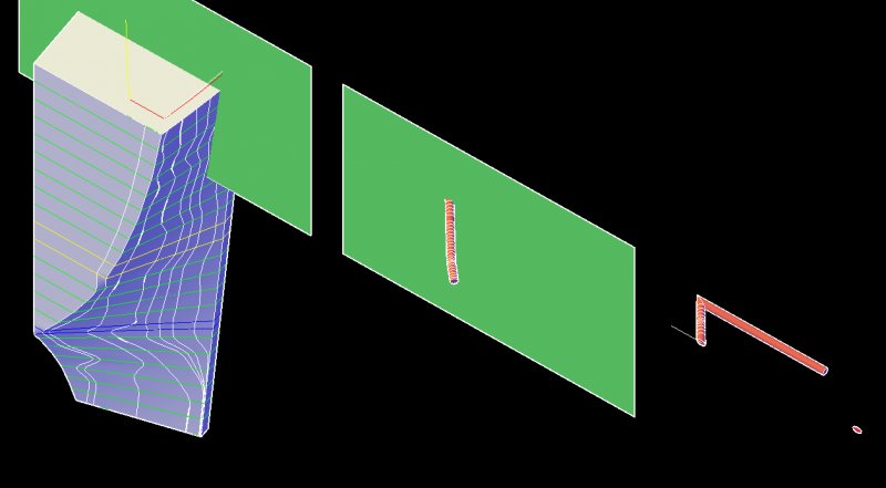

Hrcko Posted September 7, 2014 Posted September 7, 2014 I can't find, in the help files, how to define the point (located on the line) where the line passes through the plane. Can somebody help me about this problem, please? Here is the file: VL za krmenu protustatvu - 2.dwgFetching info... Quote
MSasu Posted September 8, 2014 Posted September 8, 2014 Extrude a closed shape (i.e. a rectangle) along said line and call SLICE or SECTION to cut the resulted solid with your plan. Based on how you aligned the shape to the line (corner or middle), will get the desired point. Quote
Hrcko Posted September 8, 2014 Author Posted September 8, 2014 Thank you, MSasu. I will try your "recipe" and see what I will get. Quote
ReMark Posted September 8, 2014 Posted September 8, 2014 I would extrude a circle rather than a box. After the slice is completed draw a short line segment to or from the center and check its Properties. Quote

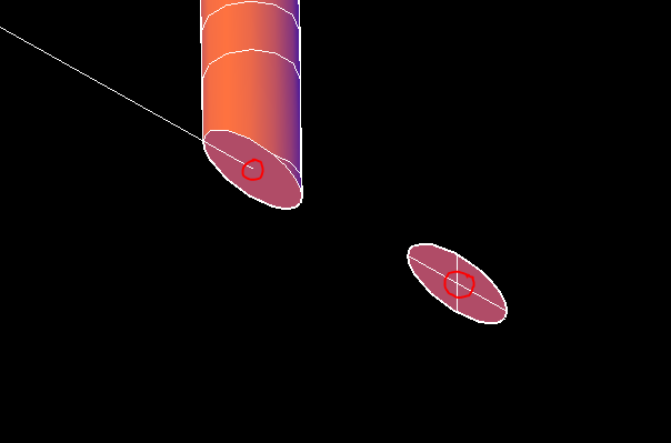

ReMark Posted September 8, 2014 Posted September 8, 2014 This... ...then this. Does that work for you? Quote
Hrcko Posted September 8, 2014 Author Posted September 8, 2014 Does extruded circle have very small diameter? Thank you for the advice, I am trying it. Quote
ReMark Posted September 8, 2014 Posted September 8, 2014 Mine does but that is just because I decided that was what I wanted to use. Size doesn't matter since the center will still be the center no matter the diameter. Quote

Hrcko Posted September 8, 2014 Author Posted September 8, 2014 ReMark, I can't obtain the picture like your second one, in your last post. Quote
ReMark Posted September 8, 2014 Posted September 8, 2014 Hrcko said: ReMark, I can't obtain the picture like your second one, in your last post. In that picture the object on the left would be the remainder of the extruded cylinder after erasing the portion that would be in front of the cutting plane. The object on the right, which in this case is a circle, was derived from exploding the 3D solid cylinder and erasing all unnecessary surfaces leaving just the circular region. I drew in the vertical and horizontal lines, between quadrants, for emphasis. Re: JDM's post. It's his nice way of saying if one were using Inventor this kind of exercise would be accomplished with far less effort. Quote

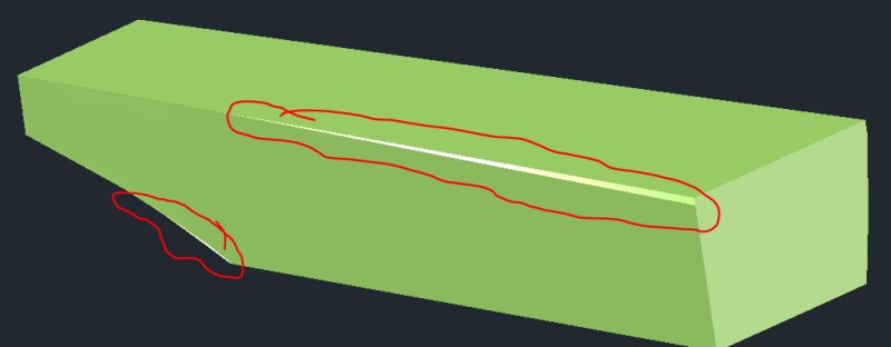

Hrcko Posted September 9, 2014 Author Posted September 9, 2014 I avoided one problem and encountered the other one. Now, I can't convert the body made of surfaces to 3D solid. Here is the file with the drawing: Rebra za krmenu protustatvu3.dwgFetching info... Quote

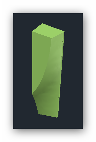

JD Mather Posted September 9, 2014 Posted September 9, 2014 Something like this? (see attached) Boat.dwgFetching info... Your model did not appear to be watertight - probably not sea worthy. Quote
Hrcko Posted September 9, 2014 Author Posted September 9, 2014 Thank you JD Mather! I did not notice that my "solid" is hollow. And yes, I need something like this (boat.dwg)! Quote
JD Mather Posted September 9, 2014 Posted September 9, 2014 I saw a lot of other problems - and I am trying to decide whether to take (find) the time to show you how I would have done it in AutoCAD. Trouble is - I consider AutoCAD to be something akin to torture and I am not sure I could motivate myself. Quote
Hrcko Posted September 9, 2014 Author Posted September 9, 2014 You already did a lot for my 3D solid, there is no need to torture yourself by diving into my bad drawing. I will compare my drawing with that you attached and try to learn something. Thank you and have a nice day. Quote
JD Mather Posted September 9, 2014 Posted September 9, 2014 I didn't "fix" anything - a lot of problems with the file I attached. (look directly from back or top views) There are faces that should be planar, but are not. Quote

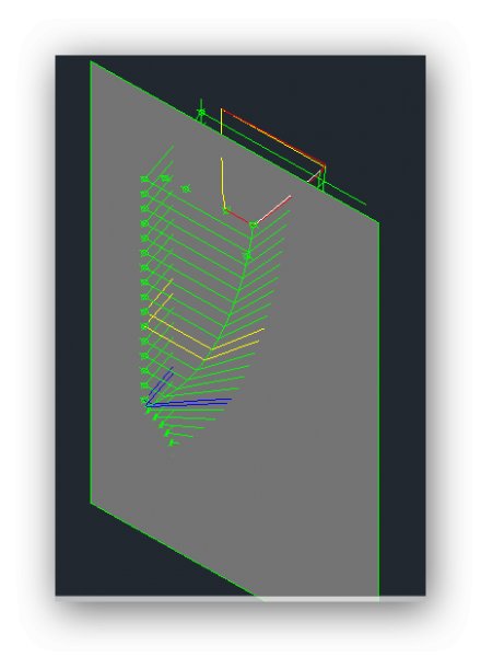

lrm Posted September 23, 2014 Posted September 23, 2014 Get an edge view of the cutting plane (be sure that perspective view is off) and use UCS [Enter] V [Enter] to make the UCS parallel to the screen. Now you can use TRIM to trim polylines to the cutting plane. ~lrm Quote
