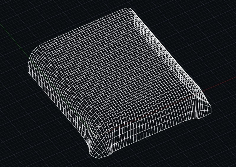

FazBear Posted September 6, 2014 Author Posted September 6, 2014 (edited) Here's an image of what i'm able to create using lofts and surfacepatches, really slow process and the result is not great. And below is an example of the kind of effect im looking to try create Edited September 6, 2014 by FazBear Quote
SEANT Posted September 6, 2014 Posted September 6, 2014 Have you tried manipulating the Control Vertices of a Nurbs surface? Duvet.dwgFetching info... Quote

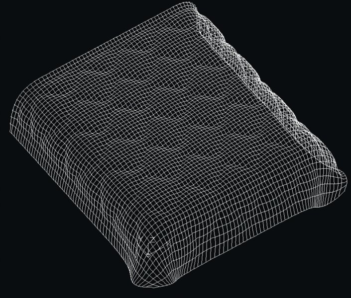

FazBear Posted September 6, 2014 Author Posted September 6, 2014 (edited) Hi Seant, thanks for the tip and model. I did have a try but was unsure how to go about adding a thickness to it or how to add the tight ripples in the texture. I guess creating a thickness isn't essential as you will never see it but i would love to learn how to apply the ripples. Is it a case of adding more CVs and press/pull them to create the effect? Using the model you uploaded i increased the number of verticies and managed to get a ripple effect on the end of the duvet. I can see this been very difficult to get the ripples looking as fluid as in the example above. Edited September 6, 2014 by FazBear Quote
SEANT Posted September 7, 2014 Posted September 7, 2014 Some combination of Displacement-, Normal-, and BumpMapping are typically applied to the surface to allow for more realistic renders. I don't do much rendering these days, but here is an example of displacement mapping. Quote

SEANT Posted September 7, 2014 Posted September 7, 2014 Actually, I don't know what AutoCAD's Mental Ray based render supports. With the exception of the ScanLine/RayTrace render of old, I haven't done any photorealistic rendering in AutoCAD. My comment was more general as it relates to most renderers. Details can be added to geometry at rendertime using some of those techniques mentioned. I used a plugin to displace the nurbs surface - an unnecessarily heavy handed process if images are the ultimate goal. Quote
