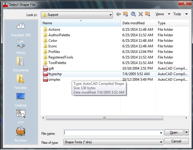

These linetypes no longer work in my drawings correctly. I haven't made any changes to the linetypes that I know of. Might be an issue with the ltypeshp.lin file. However, I didn't modify that file either. Can someone help with my problem?
I am using AutoCAD 2013
I have load the ltypeshp.shx also...................................

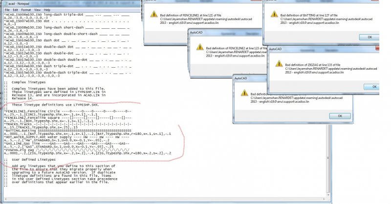

This was copied out of my acadiso.lin file.
;; Complex linetypes
;; Complex linetypes have been added to this file.
;; These linetypes were defined in LTYPESHP.LIN in
;; Release 13, and are incorporated in ACAD.LIN in
;; Release 14.
;; These linetype definitions use LTYPESHP.SHX.
*FENCELINE1,Fenceline circle ----0-----0----0-----0----0-----0--
A,6.35,-2.54,[CIRC1,ltypeshp.shx,x=-2.54,s=2.54],-2.54,25.4
*FENCELINE2,Fenceline square ----[]-----[]----[]-----[]----[]---
A,6.35,-2.54,[bOX,ltypeshp.shx,x=-2.54,s=2.54],-2.54,25.4
*TRACKS,Tracks -|-|-|-|-|-|-|-|-|-|-|-|-|-|-|-|-|-|-|-|-|-|-|-|-
A,3.81,[TRACK1,ltypeshp.shx,s=6.35],3.81
*BATTING,Batting SSSSSSSSSSSSSSSSSSSSSSSSSSSSSSSSSSSSSSSSSSSSSSS
A,.00254,-2.54,[bAT,ltypeshp.shx,x=-2.54,s=2.54],-5.08,[bAT,ltypeshp.shx,r=180,x=2.54,s=2.54],-2.54
*HOT_WATER_SUPPLY,Hot water supply ---- HW ---- HW ---- HW ----
A,12.7,-5.08,["HW",STANDARD,S=2.54,U=0.0,X=-2.54,Y=-1.27],-5.08
*GAS_LINE,Gas line ----GAS----GAS----GAS----GAS----GAS----GAS--
A,12.7,-5.08,["GAS",STANDARD,S=2.54,U=0.0,X=-2.54,Y=-1.27],-6.35
*ZIGZAG,Zig zag /\/\/\/\/\/\/\/\/\/\/\/\/\/\/\/\/\/\/\/\/\/\/\/
A,.00254,-5.08,[ZIG,ltypeshp.shx,x=-5.08,s=5.08],-10.16,[ZIG,ltypeshp.shx,r=180,x=5.08,s=5.08],-5.08
;; Linetype Definition related to JIS Z 8312

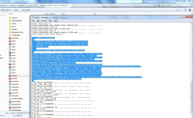

It looks to me like your linetype path is set to acad.lin, but your previously correct linetypes are actually in acadiso.lin
The screen shot is different to the copy-and-pasted linetype definition that you posted. I would consolidate those files, or remove one from the Support folder while you are testing it. Make copies of them before you start though!

I don't know where the problem would have been, probably in the search paths. AutoCAD is fairly stable, but it is only as good as the library files it is pointing to. Are the .lin file or the .cuix file shared with any other users?
thanks yz for replied to my thread;
No, the cad supported folder files are not shared with anyone?
when I saw the error I should attach the cad file to my thread, but it's so big than 1MB ( possible to reduce it)
I purge the file, many line types deleted, next day it seem ok...........
