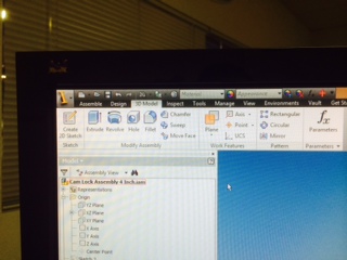

vertical horizons Posted September 3, 2014 Posted September 3, 2014 Using AutoCAD Mechanical 2013, I can not find the EMBOSS Icon. Where is this button located? I even searched GOOGLE & YOUTUBE, but couldn't find an answer there, either. Quote
ReMark Posted September 3, 2014 Posted September 3, 2014 Maybe the command does not exist in Mechanical. I know there is an emboss feature in Inventor. What exactly are you embossing? Is it text? Quote
vertical horizons Posted September 3, 2014 Author Posted September 3, 2014 I'm sorry. My mistake. We use AutoCAD Mechanical & Inventor. I meant to say Inventor, instead of AutoCAD. And yes, I am trying to emboss text. Quote
ReMark Posted September 3, 2014 Posted September 3, 2014 Did you look on the Create panel on the 3D Model tab? Quote
vertical horizons Posted September 3, 2014 Author Posted September 3, 2014 I don't see it on the "CREATE" tab. Quote
ReMark Posted September 3, 2014 Posted September 3, 2014 You are look for the Create panel on the 3D Model tab. Please confirm the version you are using. And while you are at it read this as it is specific to Inventor 2013... http://books.google.com/books?id=G4fqBmJ2O0QC&pg=RA1-PA6&lpg=RA1-PA6&dq=inventor+emboss+tool&source=bl&ots=khhwl5j9XJ&sig=lUXaFxf8TKO9tNpeAIBd0w2hBV4&hl=en&sa=X&ei=dTMHVMmMNJOONrD-goAE&ved=0CB0Q6AEwADgU#v=onepage&q=inventor%20emboss%20tool&f=false Quote
JD Mather Posted September 3, 2014 Posted September 3, 2014 You took a picture of your monitor? Simply use the Windows Snipping tool. You are in an assembly. Emboss is in the part environment. Quote
vertical horizons Posted September 4, 2014 Author Posted September 4, 2014 You took a picture of your monitor?Simply use the Windows Snipping tool... You're right. I could have used the "print screen" option. I wasn't thinking. Quote

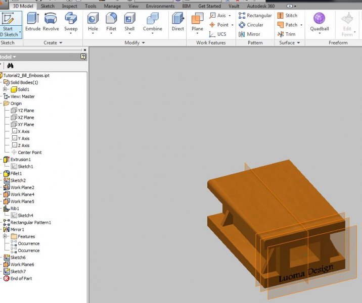

Dinochrome Posted January 6, 2016 Posted January 6, 2016 Hmm. I'm working through tutorials. I am in a part environment. I made a sketch and added text to it. I am back out on the 3D workspace. When I try to find EMBOSS on the ribbon below create it does not appear. I did check the drop-down arrow. There is only DECAL left below off the ribbon. Thanks in advance. Bill Quote
Dinochrome Posted January 6, 2016 Posted January 6, 2016 The Ribbon doesn't stay persistent for use with Clipping Tool. Quote
Dinochrome Posted January 6, 2016 Posted January 6, 2016 ...I found it buried under the drop-down below SWEEP. Quote
gbradley Posted January 7, 2016 Posted January 7, 2016 Whats under the Down arrow below sweep? Oh! I see you found it. Quote
Dinochrome Posted January 21, 2016 Posted January 21, 2016 Yep, Thanks! (Hindsight I could have posted a picture with Printscreen/Paint...) Do we have tags? Emboss, pull-down, menu, icon, Quote
