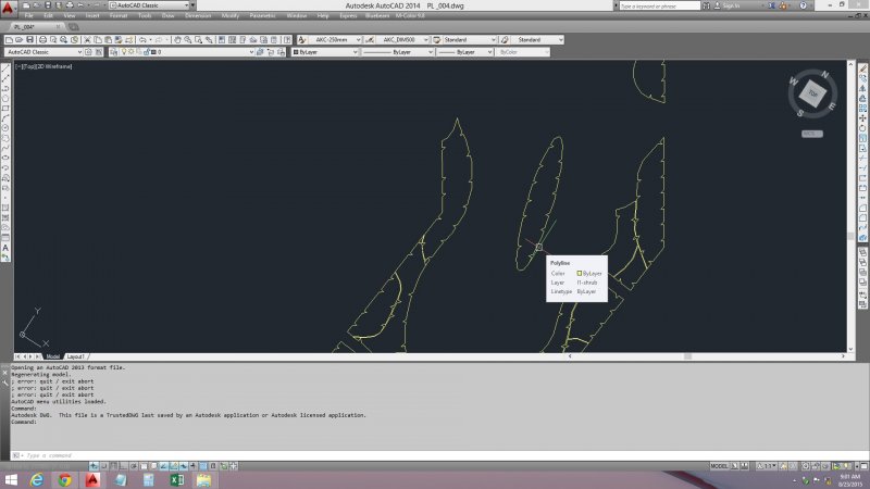

Hi,
Attached is the planting boundary i have to create.
if anybody has lisp to draw similar lines and willing to share , please share your code.
Linetype wont work with as i need to hatch later if required.
Thanks..
PS: I tried mkltype and used wmfout and wmfin. there is gap between shape and curved lines.

Express has a break routine built in you may be able to call it somehow from a lisp to automate.
Thanks Bigal for your valuable suggestion,
Try this routine and it should do the trick as needed .
NOTE: do not use the routine on arc segment of a polyline , cause you'd have unexpected result .

Hi Tharwat,
Thank you very much for your code.
Currently the code creates desired shape on each pick. Is there any other way to code it so that it could create desired shapes in one shot with input of shape size and spacinng. Also for curved segments, draw segmented poly line and incorporate shape in it.

Sir,
Please give lisp which can convert any closed LWPOLYLINE to Ziz Zag lines as shown in the attached file (The enclosed area should remain the same.
https://www.dropbox.com/s/0xo26ytciypwab3/demo.dwg?dl=0

Further sized down version which can open in autocad 2007 for convenience
demo1.dwg
