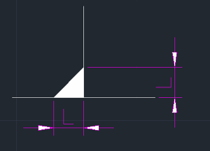

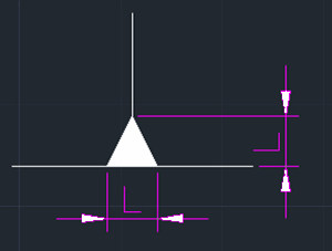

I have an idea, want to use lisp to do these things. Someone can help me ?
1.Enter the length of "L" , Then Pick up two perpendicular lines ,maybe is Plines.
Draw a isosceles triangle, and hatch.
eg.
2. Enter the length of "L" , Then Pick up two perpendicular lines ,maybe is Plines.
Draw a right triangle, and hatch.
eg. Maybe need to choose which side .

Try this routine , and press TAB button to step through triangle shapes .

Mr.Tharwat. Thanks for your help. But, maybe like this, how to handle ?
Not a problem at all , try the modification and let me know ;)
