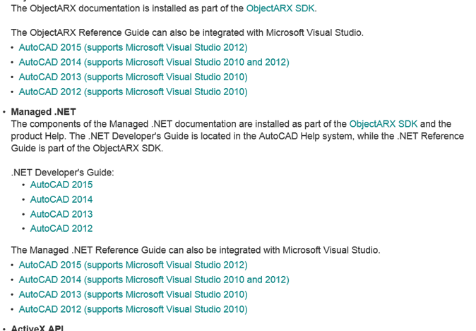

RICVBA Posted August 30, 2014 Posted August 30, 2014 We'd be happy to help... Try reading through some of the recent threads in the .NET forum, as you're not alone. I have a submittal, and some server upgrades to spec out today, and will check back as time permits, should someone smarter than I not have already helped you. Cheers I got my "Hello World" kick off running. But where can I get the Autocad API reference, as I could with "AutoCAD ActiveX and VBA Reference"? There I could get extensive explanations and examples too. I already went through http://docs.autodesk.com/ACD/2010/ENU/AutoCAD%20.NET%20Developer's%20Guide/index.html but it's much less wordy and, mainly, seems to lack a lot of references. I need to get at help/reference for all of the classes, and their properties and methods, that I can see in the object browser for AcdbMgd.dll and the likes. Quote
SEANT Posted August 31, 2014 Posted August 31, 2014 A full listing of the ARX APIs, both managed (.Net) and native, can be found here: http://usa.autodesk.com/adsk/servlet/item?siteID=123112&id=785550 These docs do not contain examples - as did the VBA Reference - but do provide fully qualified namespace listings to use via web search. Chances are, a pertinent example is out there. Quote
RICVBA Posted August 31, 2014 Posted August 31, 2014 thank you Seant so this means there's no chance to reach the help relevant topic by pressing F1 while coding in the IDE, rather I have to open those "chm" files separately, isn't it? Quote
SEANT Posted August 31, 2014 Posted August 31, 2014 See if the option on this page help in that regard: http://usa.autodesk.com/adsk/servlet/index?id=1911627&siteID=123112 Quote
