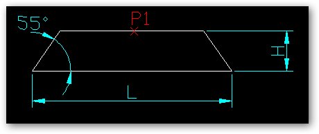

Hi guys
Have a routine like this? Thanks for any help!
Enter the value of the " L " and " H" , pick a basic point , Dynamic specified direction. Draw an isosceles trapezoid.
A good start for learning lisp very easy just a couple of commands think of it as 5 pts 1st point is pick point then using new pt = polar angle distance or old fashioned trig can work out all the corners then create pline pt1 pt2 pt3 pt4 C and then rotate.
Try this Andy and let me know :)

Many Thanks , Tharwat. It's nice! Is just what I need !
Happy to hear that and you are welcome .

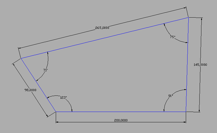

Kindly asking to another solution to draw difference four sides (input) and angle of trapezoid (angle not fix). How to add more feature in your code? Thank you in advance.
As Lee is stating without a known angle there is no solution. How do you do this now you must be fixing something or do you have a diagonal distance then its solvable.
Having an idle moment, I tried to draw the shape as dimensioned. Not straight forward :shock:
Eldon I got Length = 263.495 not 265 so diagram is not correct for whole degrees
When I saw the picture, I thought that it showed typical OOB settings, with the length precision set at 4 and the angle precision set at 0, with decimal degrees set in the dimensions.
So that meant that there was up to half a degree tolerance in each angle, which when dimensioned would be as shown.
I got 1.8 units misclosure going round with whole angles. So I adjusted angles here and there, keeping the adjustments below half a degree.
For the record, here are the angles that I used:-
70°-33'-34" (dimensioned as 71°)
74°-45'-54" (dimensioned as 75°)
91°-29'-55" (dimensioned as 91°)
123°-10'-37" (dimensioned as 123°)
These values are probably not unique, but once I had found one set, I was content.
Regarding uniqueness: if all four lengths are constrained, only one angle is required for uniqueness; if all four lengths are given & more than one angle is specified, the geometry will be over-constrained unless the given angles are exact. I find the best way to visualise this is to reduce the problem to a rectangle which may be deformed into an infinite set of parallelograms unless an angle is given.

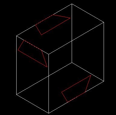

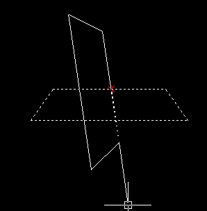

Why can't use for 3D mode ,:cry: , like this .
  • 3 weeks later...
Dear Tharwat
[ATTACH=CONFIG]54752[/ATTACH]
Yes , This is a disadvantage.
Hi Tharwat. can fix this ?
Tharwat tried using new ucs in plane but did not work, a more polar method 4 points would, but anyway I cheated and used rotate3d to get the answer. Something in the entmakex.
Edited by BIGAL

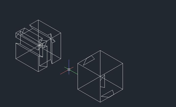

[ATTACH=CONFIG]54913[/ATTACH]
Hi BIGAL ,Can you fix this?
feasible? BIGAL
