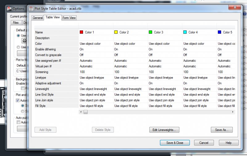

EJMpurdue Posted August 21, 2014 Author Share Posted August 21, 2014 Thanks for the suggestion...I still can't figure it out. I changed the plot style to acad.ctb and checked the color settings. I did a screen capture, and tried to attached it...hoping it works when I post this. Maybe I'm missing something simple. All the colors say 'use object color'. I wasn't sure if you meant change the actual color of the layer to something above 10, but I tried that as well. Quote Link to comment Share on other sites More sharing options...
