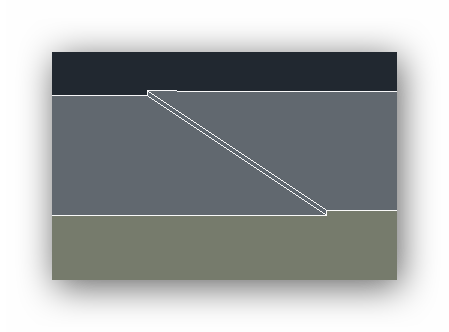

Hrcko Posted August 16, 2014 Posted August 16, 2014 Hi! I have one line on the surface of the solid. I do not need this line, but I can't select it for deletion. How to select this line? Thank you for the help! Quote
ReMark Posted August 16, 2014 Posted August 16, 2014 Change your point of view (using 3DRotate) and visual style (2Dwireframe) then perhaps you can select the line. Quote
JD Mather Posted August 16, 2014 Posted August 16, 2014 solidedit clean Is that one planar face? Attach your dwg file here and end all doubt. Quote
Hrcko Posted August 17, 2014 Author Posted August 17, 2014 I am sorry. Mea culpa! The line in the question was not only the line. It was the discontinuity in the surface which can be seen after multiple magnification. I thank to all trying to help me. Quote

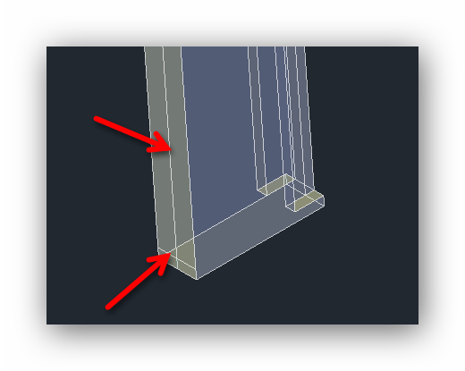

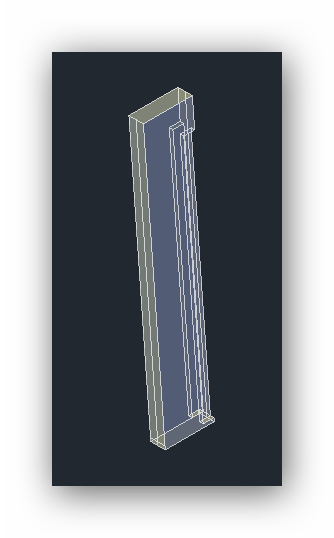

Hrcko Posted August 25, 2014 Author Posted August 25, 2014 I have (again) the problem with lines I don't need. This time the surface is continuous. One line (short one) is the consequence of moving of one surface, and the other of 3D mirroring + SOLID-UNION. The command Clean (SOLIDEDIT) did not help. The lines in question are marked with arrows. Quote
ReMark Posted August 25, 2014 Posted August 25, 2014 Have you given any thought as to why you are experiencing these types of problems in the first place? Can you attach a copy of the drawing? Quote
Hrcko Posted August 25, 2014 Author Posted August 25, 2014 Yes, here is the drawing. Leut-krmena statva.dwg Quote
ReMark Posted August 25, 2014 Posted August 25, 2014 Here is your part back. You should be more careful. How much experience do you have working in 3D? Leut fixed.dwg Quote
