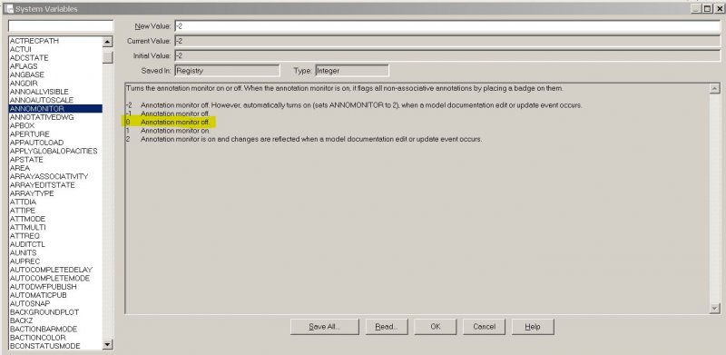

Set your ANNOMONITOR system variable to 0 is the short answer, unless I am mistaken.
Type annomonitor at the commandline >
Your current setting will be displayed, like so ,
in order to change it, enter 0, or whatever value you want to change it to and hit Enter.
Please be sure to read the explanation for why they appear, and what they mean in the atttachment.
Untiil 2012, the default setting for this system variable was turned off.
Since 2013, the default OOTB setting has been turned on.
