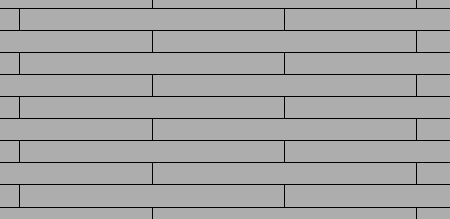

nicolas Posted August 13, 2014 Share Posted August 13, 2014 Hi to all, Need urgently a floor timber planks pattern hatch. The timber need to be 1800 x 150 mm. Your help would be much helpful. Have written something like: *WP150x1800, 0, 0, 0, 0, 1800 90, 0, 0, 0, 150 But the planks are put one after another without any staggering which is what is needed most. Thanks in advance for your help. Quote Link to comment Share on other sites More sharing options...
steven-g Posted August 13, 2014 Share Posted August 13, 2014 How much does it need to stagger, with a hatch you cannot make it random Quote Link to comment Share on other sites More sharing options...
nicolas Posted August 13, 2014 Author Share Posted August 13, 2014 Hi, If the first line start with a full rectangle 1800x150, the second can start with a 1/2 rectangle. Same principle with the laying of CMU or Bricks. Thanks. Quote Link to comment Share on other sites More sharing options...
eldon Posted August 13, 2014 Share Posted August 13, 2014 Something like this gives a half length stagger. *WP150x1800 0,0,0,0,150 90,0,0,150,900,150,-150 Quote Link to comment Share on other sites More sharing options...
steven-g Posted August 13, 2014 Share Posted August 13, 2014 (edited) Here's a few variations the last one jumps half each time. *Boards_1, Wide boards 0, 0,0, 0,150 90, 0,0,300,900,150,-450 90, 500,150,300,900,150,-450 *Boards_2, Wide boards 0, 0,0, 0,150 90, 0,0,600,1800,150,-450 90, 100,150,600,1800,150,-450 90, 600,300,600,1800,150,-450 90, 250,450,600,1800,150,-450 *Boards_3, Wide boards 0, 0,0, 0,150 90, 0,0, 150,450, 150,-450 *Boards_4, Wide boards 0, 0,0, 0,150 90, 0,0, 150,900, 150,-150 Edited August 13, 2014 by steven-g Quick change I read your first post as 800 instead of 1800 1 Quote Link to comment Share on other sites More sharing options...
nicolas Posted August 13, 2014 Author Share Posted August 13, 2014 It works perfect. Thanks you very much. Quote Link to comment Share on other sites More sharing options...
