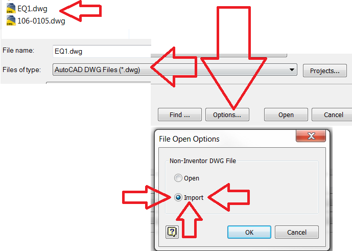

JD Mather Posted August 12, 2014 Posted August 12, 2014 Sengna said: .....what about if i already have it in drawn in autocad, can i import and extrude it?..... Attach example dwg file here. There are at least 3 ways to do this. If you Open, be sure to set Options to Import. Quote
Sengna Posted August 12, 2014 Author Posted August 12, 2014 JD Mather said: Attach example dwg file here. There are at least 3 ways to do this.If you Open, be sure to set Options to Import. let say i want to extrude this 5' long EQ1.dwgFetching info... Quote
JD Mather Posted August 12, 2014 Posted August 12, 2014 I would explain how to File>Open AutoCAD *.dwg with Options set to Import, but that geometry is tooooooo trivial. Simply recreate in Inventor - about 30 seconds of work. And use symmetry about the origin. I recommend going through this http://www.cadtutor.net/forum/showthread.php?85808-Inventor-101 Quote

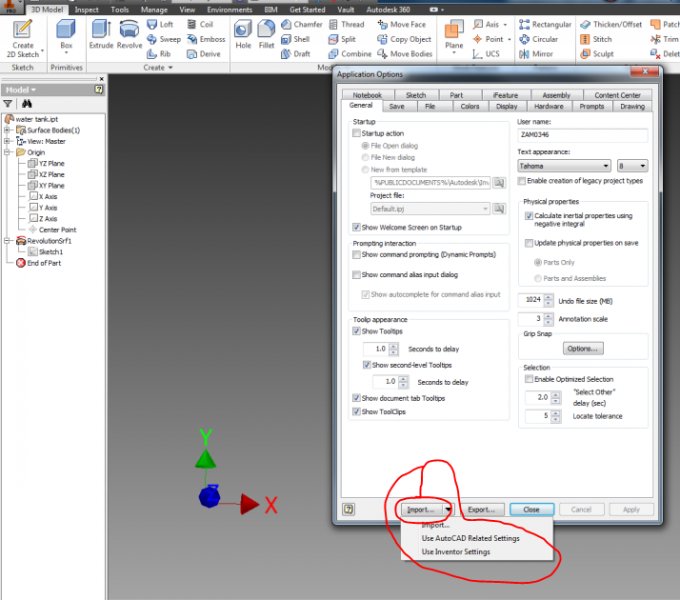

Sengna Posted August 13, 2014 Author Posted August 13, 2014 JD Mather said: I would explain how to File>Open AutoCAD *.dwg with Options set to Import you mentioned options set to import, Did you mean i need to go to setting like below? i will read through your Lesson. I have been away from inventor study more than a month now. i am back. thanks JD Quote
