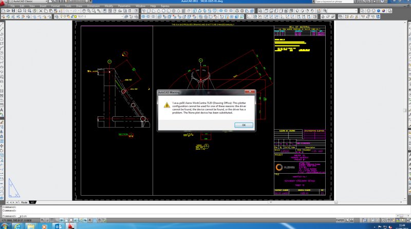

However - when I go to print - the following message appears (see attached screen shot).

The printer name is saved in the drawing, in fact it's saved in each layout.
There is no "default" printer, unless you are dealing with "pre-AutoCAD 2000" drawings.
So you can either rename your new printer PC3 file to match the old name, or change the printer each time you run across this in a layout. Once you save it, it will stick until you need to change it again.
