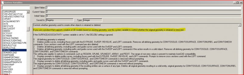

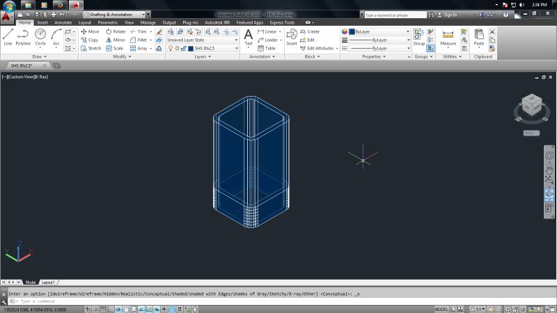

autocad2014newbie Posted August 11, 2014 Author Posted August 11, 2014 I had the chance to experiment with the sweep command earlier today by following one simple polyline. It seems like a very powerful command. I can see myself using it a lot in the future. The proper steel structure terms will definitely help a lot in my search for dimensions from online resources to draw from. I have one question though, regarding some of the models Dadgad posted. I opened the very first model, and tried the explode -> extrude or presspull command ReMark advised about earlier, but am having this issue where instead of pulling the tube up from its point of origin, it stacks a new one on top and pulls that one instead. What am I doing wrong here? Quote
ReMark Posted August 11, 2014 Posted August 11, 2014 Maybe Dadgad constructed his blocks out of surfaces or you exploded the block more than once turning a solid into a surface. Quote
Dadgad Posted August 12, 2014 Posted August 12, 2014 ReMark said: Maybe Dadgad constructed his blocks out of surfaces or you exploded the block more than once turning a solid into a surface. The drawings I posted are all closed polylines (as far as I know), they were meant to be, I was doing about a couple hundred of them a day, ready to use in whatever way is appropriate. Each drawing also contains the kg/m profile weight. I typically just copy and paste them into whatever I am working on. None of them are 3D Solids, they should all be closed 2D Polylines. Quote
autocad2014newbie Posted August 12, 2014 Author Posted August 12, 2014 Wow, you were right. I must have exploded the object twice then. Was able to PressPull with ease this time. I have one question regarding all you guys personal design practices. I would like to design models to exact scale, that way when I use the Measure tool, it would be like pulling out a real measuring tape in real life to measure the real thing. I've heard Autocad's programmatical unit of measure by default is Units, which one can then take to convert and mean what ever they want it to be visually. I notice dadgad's models are in decimal, so when I type Units command to change to architecture, one side of the square tubing blocks measure's 1 ft. 8 inches. Is there a reason for designing this way in Decimal and Insertion: Unitless, which results the sides to scale that big? What are the advantages of this, and when it comes to scaling the real thing, how is this measured/displayed? And what is the significance of Insertion scale in the Units dialogue box? What does it the affect the scale of exactly? Blocks I insert or anything I draw, or? And how exactly does it affect it's scale just by defining what to be measured as or? I would imagine a property named insertion scale to have text boxes with certain measurements, so this is why I'm a little bit confused on this. Quote

Dadgad Posted August 12, 2014 Posted August 12, 2014 (edited) autocad2014newbie said: I had the chance to experiment with the sweep command earlier today by following one simple polyline. It seems like a very powerful command. I can see myself using it a lot in the future. The proper steel structure terms will definitely help a lot in my search for dimensions from online resources to draw from. I have one question though, regarding some of the models Dadgad posted. I opened the very first model, and tried the explode -> extrude or presspull command ReMark advised about earlier, but am having this issue where instead of pulling the tube up from its point of origin, it stacks a new one on top and pulls that one instead. What am I doing wrong here? [ATTACH=CONFIG]50345[/ATTACH] I have attached a screenshot from the SYSVDLG command (try it you'll like it) dialog box, describing the system variable DELOBJ, which controls the management of defining geometry used to create 3D Solids and such. I am guessing that you still haven't watched the EXTRUDE and PRESSPULL tutorial on the tutorial tab, http://www.cadtutor.net/tutorials/autocad/extrude-and-press-pull/ I hope I am wrong about that. Edited August 12, 2014 by Dadgad Quote
ReMark Posted August 12, 2014 Posted August 12, 2014 (edited) autocad2014newbie said: I had the chance to experiment with the sweep command earlier today by following one simple polyline. It seems like a very powerful command. I can see myself using it a lot in the future. The proper steel structure terms will definitely help a lot in my search for dimensions from online resources to draw from. I have one question though, regarding some of the models Dadgad posted. I opened the very first model, and tried the explode -> extrude or presspull command ReMark advised about earlier, but am having this issue where instead of pulling the tube up from its point of origin, it stacks a new one on top and pulls that one instead. What am I doing wrong here? [ATTACH=CONFIG]50345[/ATTACH] First of all, Dadgad provided you with blocks. Your mistake was you opened the actually drawing then exploded it when you should have used the INSERT command and brought the block into your drawing. Unfortunately learning AutoCAD, especially 3D AutoCAD, solely by watching videos may be all well and good, but if you do not possess the proper foundation (i.e. - the "basics") you lack the fundamental knowledge to correctly use the program. Second, Dadgad's drawing (ex. - SHS 30x2.5) consists of two lightweight polylines. When these are exploded you end up with eight lines and eight arcs. These are now all separate entities. The only way you can create a solid from these sixteen entities is to use the PressPull command. If you try using the Extrude command you'll end up with sixteen individual surfaces. Knowing that a continuous polyline when exploded yields a series of separate entities is again basic knowledge that you have missed learning in your eagerness to jump right into 3D without first exploring the fundamentals of the program. I tried to reproduce the "stacking" affect you speak of but failed. I'm not sure what you did there. I would have to see you drawing in order to figure it out. Edited August 12, 2014 by ReMark Quote
