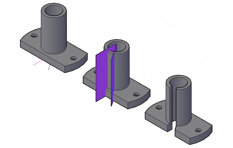

Also, at a quick guess, I believe you are using the 4th point to specify the direction of the solid you want to keep visible. Instead, your 4th point is a continuation of the jogged section plane, so your model is also being sectioned between point 3 and 4, and that's why you are seeing a thin slice of material.
Another approach using the SLICE command with the Surface option.
Note that the 3D model is only loosely based on your drawing. This was for demonstration purposes only.

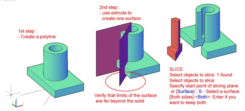

Plus I am completely blank as to how I can use a Slice > Surface..I do not know what to select or how I can select a specified surface :( As of the moment I cannot find any tutorial with using the slice>surface...that is the same also with the section>3points. I had seen an ebook --- Acad 2010 Bible by Ellen Filkenstein but the sample there the same as cutting the object in half only (pages 798 - 803). The slice example there shows 4 points to slice the example. Why 4 points when you can slice that in two-points...? I may be understanding it wrong also....
As explain it Remark, section by surface, it's the best way to slice your object. To make work, you have to create one polyline and use extrude to create one surface. See image
Thank you very much for the image tutorial rvpas. I now managed to do the slice > surface based on it :)
