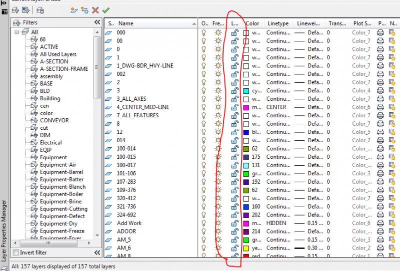

Sengna Posted August 7, 2014 Posted August 7, 2014 How can i unlock the drawing for editing? i received the drawing from other client that is locked. I tried to offset a line or move but it didn't work, it showed the little lock icon when i hover over the line. appreciate any help. Quote
MSasu Posted August 7, 2014 Posted August 7, 2014 Please note that the layer containing that entity is locked, not the entire drawing. Just open the pop-up list of layers (or call LAYER command) and click on the lock icon of the layer containing said item. 1 Quote
Sengna Posted August 7, 2014 Author Posted August 7, 2014 MSasu said: Please note that the layer containing that entity is locked, not the entire drawing. Just open the pop-up list of layers (or call LAYER command) and click on the lock icon of the layer containing said item. "Pop up list of layers" were you referring to layer manager? Quote
Sengna Posted August 7, 2014 Author Posted August 7, 2014 I went to check on the layer manager window, all layers are unlocked, but i was unable to do anything ex: move, offset, match Prop, change color.... What else could each be? anybody have any idea? Quote

Sengna Posted August 7, 2014 Author Posted August 7, 2014 I tried to removed the geometric constraint using DELCONSTRAINT, it still show that padlock next to any line i clicked. I used DELCONSTRAINT command before for other dwg, it worked but not on this one. i tried to just copy any obj on the screen and set a side but nothing being copied. Weird. Quote
