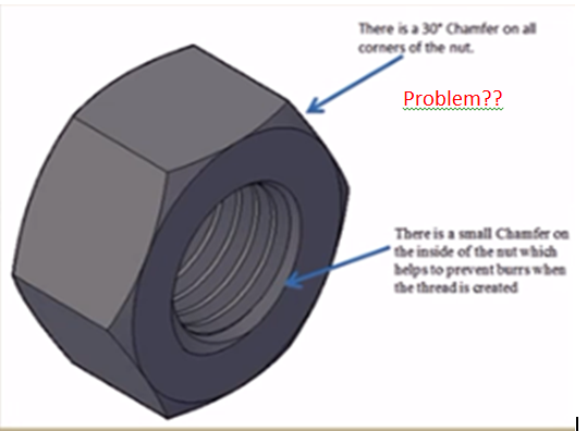

hamidciv Posted August 5, 2014 Posted August 5, 2014 hi dear freiends :(i want drawing nut Shown in the figure below, my problem Is corners of nut the chamfered under angle 30 degress in both side, how do this? thanks a lot Quote

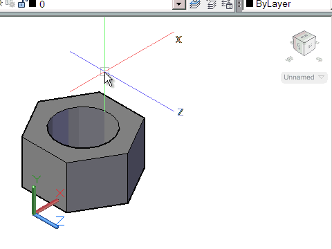

nestly Posted August 6, 2014 Posted August 6, 2014 Revolve a line to create a surface, then use the Surface to SLICE the Solid Quote
hamidciv Posted August 6, 2014 Author Posted August 6, 2014 dear nestly for define line, These lines must be defined by the coordinates?(whether the z coordinate is zero)?? thanks Quote
ReMark Posted August 6, 2014 Posted August 6, 2014 nestly isn't picking coordinates he is picking a point on the 3D model to draw his line. Then he rotates the line minus 30 degrees. Quote
hamidciv Posted August 6, 2014 Author Posted August 6, 2014 hi dear remark Did you mean to rotate in top post is rotate? if your possible explain more my question with use method nistly or The way your offer. thanks remark Quote
ReMark Posted August 6, 2014 Posted August 6, 2014 I was talking about the line that nestly drew from the top edge of the nut. He rotated it -30 degrees then revolved it to create a surface. This is the surface he used to trim away a portion of the nut to create the chamfer. Follow me? Quote

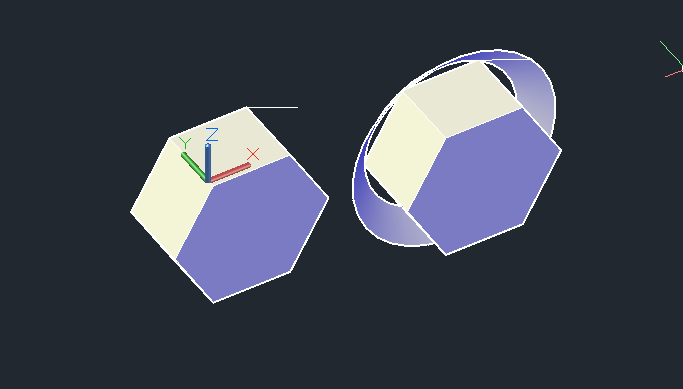

hamidciv Posted August 6, 2014 Author Posted August 6, 2014 yes i follow our speak, i follow method of nistly but My model comes in the form below,Where is my problem?? thanks remark Quote
SuperCAD Posted August 6, 2014 Posted August 6, 2014 You're putting the line on the corner of the nut. You need to put it on the face so the surface will cut through the corners. Put the line in the center of the faces edge. Quote
hamidciv Posted August 6, 2014 Author Posted August 6, 2014 dear supercad i put line in midpoint of edge, But my problem is not solved and as a result Was achieved. please help me Quote
JD Mather Posted August 6, 2014 Posted August 6, 2014 You used wrong edge - you will need to observe geometry more carefully. The line should be created at midpoint of Flat edge, not corner edge. Maybe you should try the extruded circle technique instead? Attach your dwg file here (before the Revolve) and someone will move the line to correct location for you. Quote

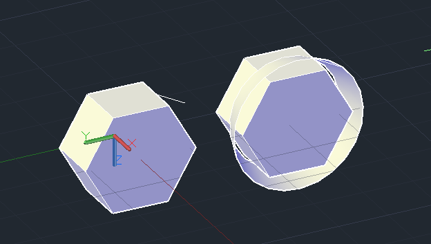

hamidciv Posted August 6, 2014 Author Posted August 6, 2014 dear jd , You mean like the following I think it is correct, please check my figure thanks Quote
JD Mather Posted August 6, 2014 Posted August 6, 2014 You should be able to do it both ways. Now let's see you do the other side with Revolved line and Slice. Quote

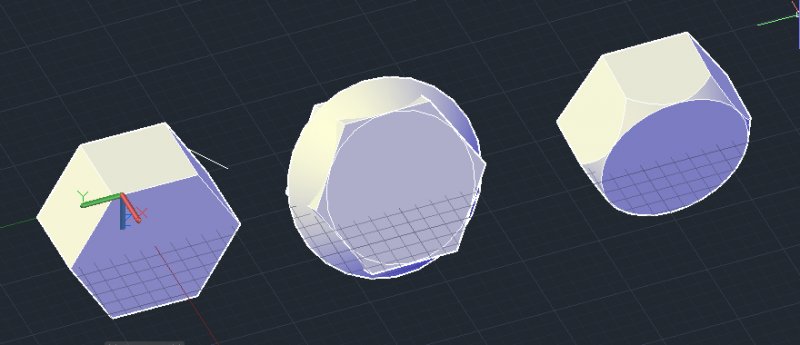

hamidciv Posted August 6, 2014 Author Posted August 6, 2014 whether in upper post, i correct define line? dear jd mather do you men other ways is extrude circle and use taper angle? thanks a lot Quote
JD Mather Posted August 6, 2014 Posted August 6, 2014 Attach your dwg file here and end all doubt. Quote
