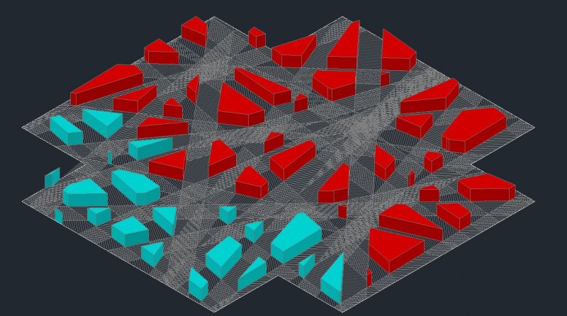

Quik&Easy Posted August 1, 2014 Posted August 1, 2014 (edited) Attached is a DWG with a flat template that will be cut and then bent to shape. The idea is to cut the negative spaces surrounded by the hatched areas. I understand what needs to be done and what I need for a final design however..... the negative space don't seem to have a pick point at the intersection of the hatched areas. As a novice, I don't know what technique might have created this design thus I don't understand how to get the negative spaces as shapes with vertices. I cannot get my cursor to pick on any interior intersection, as though the hatch areas don't actually exist. Can anyone explain how I should go about picking and outlining the desired areas? All the hatched areas could go away, I only am concerned with the perimeter and the many small negative spaces. Edited August 2, 2014 by Quik&Easy had other info I didn't mean to post publicly Quote

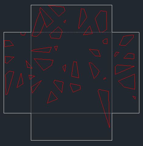

ReMark Posted August 1, 2014 Posted August 1, 2014 This is what I managed to come up with on my first try. Quote

ReMark Posted August 1, 2014 Posted August 1, 2014 I just discovered another way. I'm using the 3DPolyline command. Quote
Dana W Posted August 1, 2014 Posted August 1, 2014 Can anyone explain how I should go about picking and outlining the desired areas? All the hatched areas could go away, I only am concerned with the perimeter and the many small negative spaces. Would the Boundary command work? I tried and had some success but it wasn't 100%. Boundary can work if you are only concerned with the void areas. Just type Boundary, then click internally in the void area. A polyline will be drawn around the void area. There may be one or two areas that might not have surrounding geometry that is completely touching, but for those you can probably draw a polyline boundary around them if you have apparent intersection as one of your snap points enabled. Quote

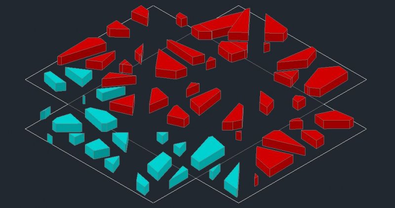

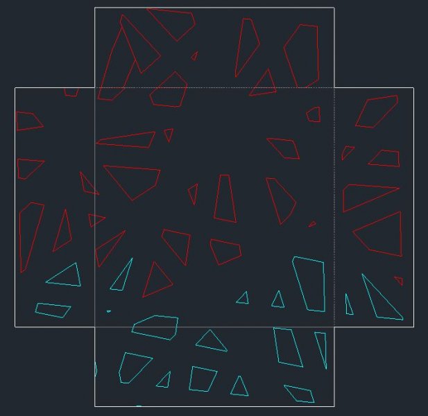

ReMark Posted August 1, 2014 Posted August 1, 2014 Corrected a few errors and added the final piece to the puzzle. I'm done. Quote
Dana W Posted August 1, 2014 Posted August 1, 2014 There are issues in the boundary command caused by the dashed bend lines around the perimeter of what I guess is the bottom of the "box". This causes some "two piece" void areas. Another issue is that somebody deleted the left side boundary line from one of the hatched stripes. That is the one that runs all the way from the left uppermost corner to the right lowermost corner. The missing line causes the boundary to be drawn up to the next closest line, which is of course on the wrong side of the hatched stripe. The issue of the fold lines can be solved simply. Just erase them, and put them back after the boundaries are all drawn. Make a new layer called Boundaries or something, and set it to a contrasting color like RED so you can see what is happening, and make that layer current while you execute the boundary command. Quote
ReMark Posted August 1, 2014 Posted August 1, 2014 Red objects were created using the Boundary command. Cyan objects were created using the 3DPolyline command. Yes, my drawing contains 3D objects called "solids". Quote
Dana W Posted August 1, 2014 Posted August 1, 2014 [ATTACH=CONFIG]50206[/ATTACH]Corrected a few errors and added the final piece to the puzzle. I'm done. There are a couple of spots where the missing original hatch boundary line is giving you intrusions into that particular hatched stripe. Quote

ReMark Posted August 1, 2014 Posted August 1, 2014 The point of the exercise wasn't accuracy. The point was demonstrate to the OP that there was a way to ascertain the negative areas. I'll leave the accuracy to the OP since it's his drawing. Quote
