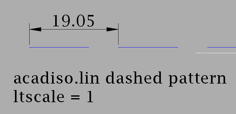

If you delve into the linetype definitions, you will see what the pattern repeat dimension is.
With the linetype from acad.lin, the repeat dimension is about 1. With the linetype from acadiso.lin, the repeat dimension is about 25.
With this in mind, if you are using metre units and acadiso.lin linetypes, then you should start off with a linetype scalefactor of 0.05. have a look at the spacing and then fine tune it to suit.
If you are using millimetre units, then start off with a scale factor of 50, and then fine tune to suit.

Hahaha nice find on that, Yes it is coming from 12D but my DWT is from a previous company that used civil cad and had the line styles where all setup in the dwt for civilcad specifically. I just modified it to suite me but there are still somethings I need to fix up which included the default line styles. I have to write a 12d mapping file for export to autocad.
Anyway with that aside I managed to sort it out
I set globalscale factor to 0.5 in LT manager then change the line scale factors to either 0.5 or 0.25 depending on desired results.
Thank you all for your assistance
D
One other thing that I would check-
Its little known but the arc and circle smoothness setting can also affect the display of dashed lines for some reason, look at-
Tools->Options ->Display->Display Resolution (Arc and Circle Smoothness)
If this is set to 0 or 1 then dashed, dotted, and chain dashed lines will appear solid, it should be set to about 100 or 200 to give smooth circles and curves as well as displaying broken lines correctly.
The default setting is 1000. If I remember correctly, it has been for over ten years. The only reason anyone would set it lower than that is because they have a computer from that era that was severely lacking on graphics hardware back then. Computers these days can easily handle a setting of 10,000.
