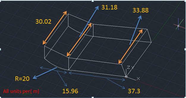

:(i want drawing shape is shown below, As shown in the figure is convergent, I have to reduce the width in longitudinal cross, please help me
i really confused.
thanks a lot

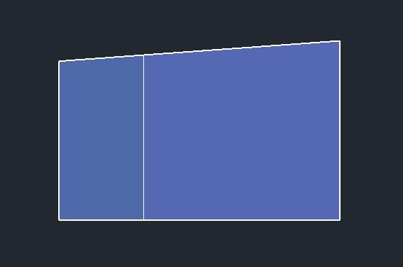

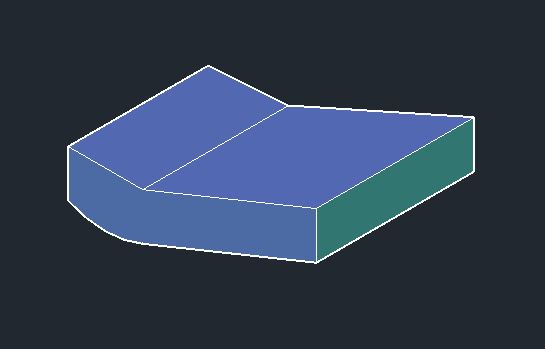

First an isometric view.
And now a top view.
Your comments?

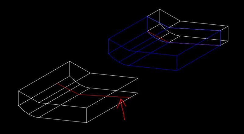

Well for one thing you left out the height. And for another we have no idea what the angle is supposed to be. I guessed at both.
I created my version of your object by lofting a profile then slicing the profile using a 3Dpolyline as my slicing object. This gave me the taper.
The red line you see was used as my slicing object. The portion of the geometry shown in blue (see model to right) was retained while the portion shown in white was ultimately deleted.

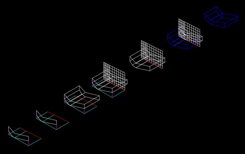

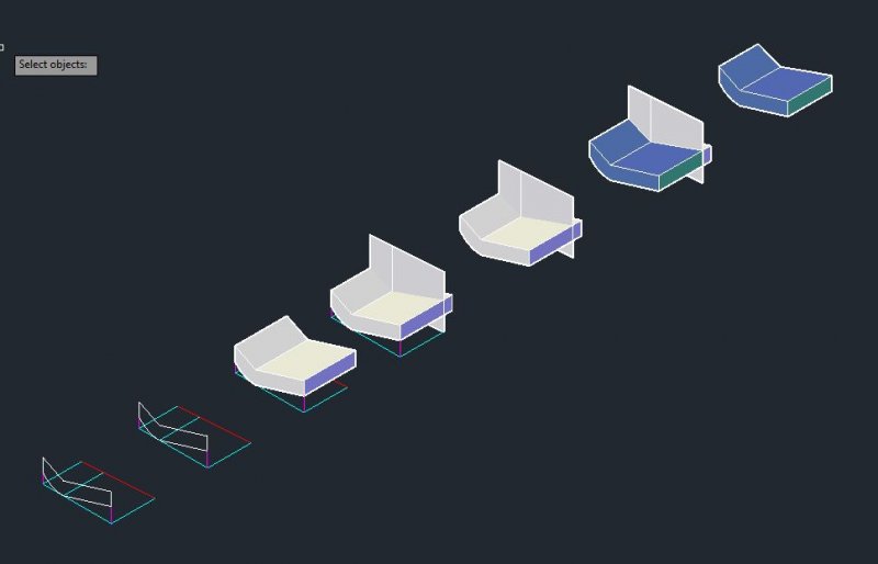

Another option: You can extrude the profile and you could slice it using a surface to get the taper. Like this:
The cyan and magenta lines you see are for locating my slicing line (shown in red). I used the Extrude and Slice (with Surface option) commands.
Here's what it looks like using a Conceptual visual style.

The width in both methods I used was based on your supplied information of 30.02, 31.18 and 33.88. This is plainly seen in the top view of an image included in post #2.
