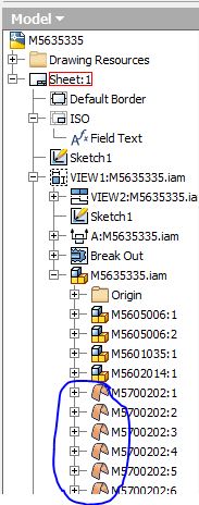

For some reason they do not have the normal Inventor part symbol, they have this symbol - see image:
I'm wondering if this is what is causing it not to show up in the Inventor DWG

They are surface bodies, not solid bodies (were they imported from STEP or IGES)?
In any case, the solution is as simple as right mouse button Include Surface Body.

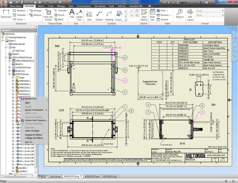

Can you direct me where to click 'Include Surface Body' please because I can't find it, whether in the part file or in the DWG?

Right click on the nodes that you have circled in blue.
The parts could probably be solidified if needed (for example if you need the mass of the assembly).
That's where I thought you meant but there is no option for that?
I can see the option in your screen shot? But it is grayed out for some reason. I would need the files to figure out why as I have no motivation to try to reproduce the behavior from scratch.
