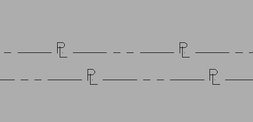

ReMark Posted July 29, 2014 Posted July 29, 2014 I got it to work using the Standard font and by emulating the line length and spacing of the Phantom(.5X) linetype with a slight tweak. See for yourself.... This is what my linetype definition file looks like. *PROPLINE,Property Line ___ _ _ ___ PL ___ _ _ ___ PL ___ _ _ ___ PL A,.625,-.125,.125,-.125,.125,-.125,.625,-.2,["PL",Standard,S=.1,U=0.0,X=-0.1,Y=-.05],-.2 Quote
ReMark Posted July 29, 2014 Posted July 29, 2014 Same linetype with a slight difference. Although Standard is the font that is called for I simply changed the font name used by Standard from the default of Arial to Txt. Note the spacing difference on either side of the letters. Quote

dal-designs Posted July 29, 2014 Author Posted July 29, 2014 Thanks for the help, everyone. Remark's definition is exactly what I needed- but it's good to know I was at least pretty close, and Eldon's explanation of what all that shorthand actually means helped, too. Quote
