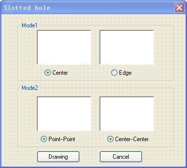

Use a period of time, not very convenient. Enter --"O" Choose "A" &"B" ,It is easy to go wrong.
Can use the DCL? like this:
I have already made SLD files:

Hi hanhphuc,
Can use the DCL?
actually you don't need to enter "options" every time for "A or B", the "option" value you enter will be set as default for the next typical sessions, so you just pick point without "options" anymore..
Pick Point or [Options] <[color="red"]Centre/mode A[/color]> ?
in red are default value
same as dcl, you only call it when you need to change its settings, not every time run it pops up then not user friendly :)
Yes, not every time run it pops up then not user friendly, but Dcl more intuitive.

Try modify the main struture code (previous post), starts from if statement..
remove the prompt input UKWORD & UKREAL
(if	(= p "Options")
     (progn [b][color="red"](fbdia)[/color][/b] (setq p nil))
[color="silver"];;;      (setq *pos* (UKWORD 1 "Centre Edge" "\nPoint from [Centre / Edge]? " *pos*)[/color]
[color="silver"];;;	    *key* (UKWORD 1 "A B" "\nSelect mode [A / B]? " *key*)
;;;	    ) ;_ end of setq[/color]
     ) ;_ end of if
Edited by hanhphuc
radioA radioB radio1 radio2
[/quote]
[b]This?[/b]
[code]  (if (null *fb_user*)
   (setq *fb_user* (mapcar 'itoa '(1 0 1 0)))

radio1 & radio2 &radioA &radioB is what ?
Need change the slide path ? The sld file and lisp file at the same folder .How to modify it ? .
This?
YES :)
radio1 & radio2 &radioA &radioB is the sld name ? and need change the slide path .
radio is key name, not sld name. you just need changing the path! never change the slide name!!
This?
the slide must be put in support folder, or create it. or try to put in short name path, ie: "C:\\LISP\\"
Thank you ,my friend ,
I put sld file and lisp in support folder, the same folder , How to modify the path?
