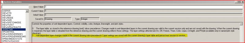

Dadgad Posted July 24, 2014 Posted July 24, 2014 (edited) Welcome Draftologist to CADTutor. Nice Avatar and Name, now that you have fixed it!. Per Dipali's suggestion, here is the SYSVDLG information regarding the VISRETAIN variable. Edited July 25, 2014 by Dadgad Quote

Dadgad Posted July 25, 2014 Posted July 25, 2014 After closing the block editor, you might try doing a REGENALL. Have you tried reopening one of those upon which you had been working, without displaying the changes, to see if those changes might display after reopening the drawing? Quote
DRAFTOLOGIST Posted July 25, 2014 Author Posted July 25, 2014 After closing the block editor , I have REGENALL -& saved file. closed it. & after reopening - No Changes are displayed. Quote

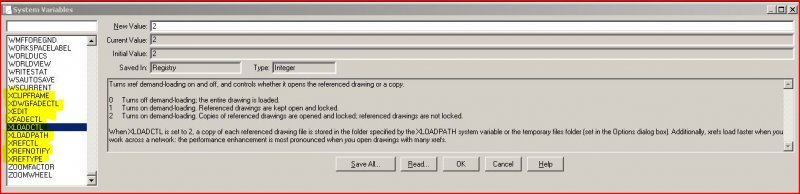

Dadgad Posted July 25, 2014 Posted July 25, 2014 Draftologist, you should spend a few minutes delving into the system variables which are XREF related, as shown in the snip from my SYSVDLG window, there aren't really that many, and some of them are clearly not complicit. I am not sure if you will have the Express Tool SYSVDLG available in your vertical or not, but that is a very good place to research likely issues caused by variable conflicts. I suggest you look at XEDIT, XLOADCTL and XREFTYPE, and pay attention to how they are related as, described there. Quote
