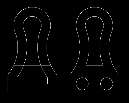

Hi,
I'd like to draw the image below in 2D but I hit a problem with the bottom part in relation to the side radius of 3.5mm.
Drawn the circle with a radius of .75 so I can use the "Circle>Tan Tan Radius" command to make the radius 4.25mm. Trimmed the excess edges and used PEDIT so I can apply offset .75mm outwards. The offset polyline showed some error that did not gel well with the bottom portioon. (the error is encircled in red). Edges would not meet as in the drawing exercise.
Now redone it using the Tan Tan Radius based on the bigger diameter but the result is the same as that of the .75 offset polyline result.
Now if I tried to drag the endpoints to meet the end of the 1.5mm x 4mm base but the radius will change. It says there that the radius will change to 4.008mm. Drawing exercise says it should be radius of 3.5mm.
Same with the bottom portion. If I drag the bottom part to meet the excess of the circle/arc created via the tan tan radius, 1.5mm x the 4mm dim will be affected. See image attached.
The other dims are correct but this radiius of 3.5mm is not. There could be something wrong with the way I did the circle with the Tan Tan Radius....
How will you do the drawing if it were you....?
Can you teach a self-studier some tips and tricks please...
Thank you!

In my opinion the dimensions are all correct. It is your approach that is in error. Draw the perimeter first then offset to the inside. Trim as required. Like this...

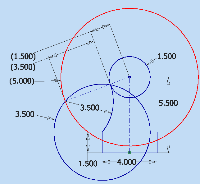

Work from the outside towards the inside as ReMark suggested.
1. You know that the center of the arc is somewhere in space 3.5 from the endpoint of the 1.5 vertical line.
2. You know that the center of the arc is somewhere in space 5 (1.5+3.5) from the center of the smaller circle.
There are only two points in space that satisfy both of those conditions.
One of the two possible solutions does not make logical sense.
You have found the unique solution. (the construction lines in the image below are not needed - I included them only for illustration)
