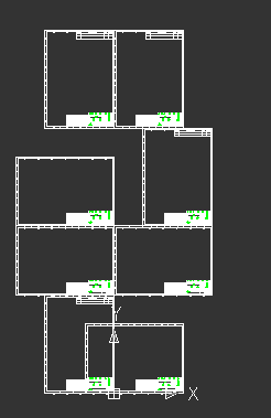

I test, But some overlap.

@andy_Lee : It's overlapped because the insertion point is not 0,0. Unless you move each drawing's lower left corner to 0,0.
That's the reason why i don't want to explode the insertion drawing.

Thanks , But I use your routine, Drawing confound.
I uploaded the drawings for the test.
I hope that arrange by drawing number.From left to right, from top to bottom
@707 , I hope you can help me update your routine. Thanks very much.
TEST.zip
Don't know why your drawing entities change all its location when inserted!!
That's maybe why you want to use xattach?
As long as you are using command calls within your Lisp that deals with coordinates , you need to switch off the OSNAP to avoid jumping to nearest objects' snaps .
