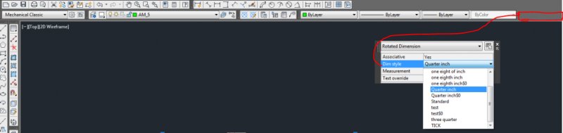

How can i get the dim style drop down show up on the top of my ribbon somewhere, what i can do right now is that i can click on any dims on my drawing and the dim would show on the quick properties list and i can change to any dim that i want that fit the plot scale ex: 1"=1', 1/2"=1', 3/4"=1'...... How i can i bring in that drop down tool and make it stays on the ribbon. thanks

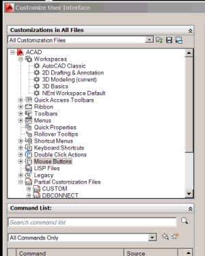

Technically, you're using toolbars, not "Ribbon" but to answer your queston, the Dimstyle Control should be part of the "Dimension" toolbar. It looks like you already have a "dimension" toolbar on the top row, so I assume it's either a custom toolbar, or at some point you removed the Dimstyle Control from the standard toolbar. Try right clicking on the dark grey area behind the toolbar(s) and put a checkmark next to "Dimension" in the AutoCAD toolbar list. If that doesn't do it, then you need to open the CUI and either drag the "DimStyle Control" into an existing toobar, or create a new toolbar to for the Dimstyle Control.

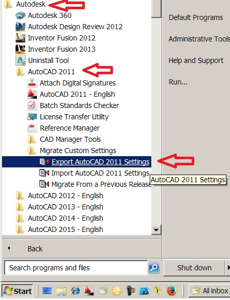

As far as backup goes, you can manually copy the Acad.cui and any other customized .cui files from your AutoCAD2010 user profile and put the in a safe location in case you need to restore your settings sometime in the future, but if 2010 has the Import/Export Settings tools on the Windows Start Menu, that's the easiest method for backing up your settings/workspaces

Also correct. Workspaces are saved within the .cui files, and AutoCAD offers several options to repair cuis/workspaces. "restore" which reloads the last saved version of the CUI, and "reset" which reloads the OOTB Cuix (which contains the OOTB workspaces)

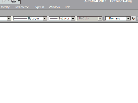

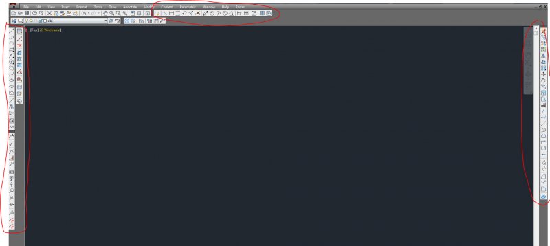

Sorry for late, I just want to be able to save all my tools that i have already set up the way i want as shown in red, there are several times that the layers properties tool bar or dim style control gone on the next day when i open the new autocad the next day. By the way my layers properties tool are missing again today.
I think we have already mentioned more than once that you should save your custom workspace under a new name. Your toolbars and tool palette locations will remain just as they are every time you open a drawing in that workspace.
[ATTACH=CONFIG]49968[/ATTACH]
Did you skip over the entire thread? I am withdrawing from further comment.
Right click in the area where no tool bars are currently being displayed, and select LOCK LOCATION > ALL.
Then go back and review the previous posts, and SAVE your WORKSPACE.
