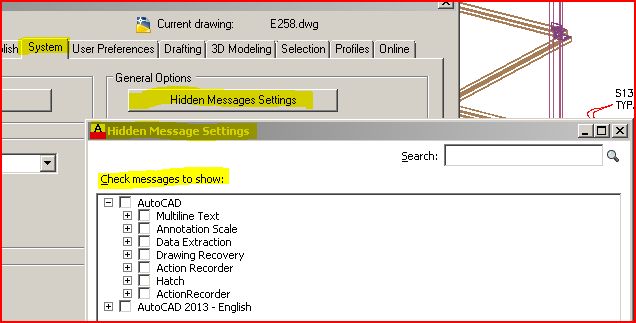

It sounds to me like you have turned off the missing font message dialog, as your default, which would identify any missing fonts correctly. In Options, go to the SYSTEM tab, and turn the HIDDEN MESSAGE back on.
Much easier to obtain the font, than to have to mess around with overrides.
