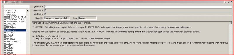

MorgaineDax Posted July 15, 2014 Share Posted July 15, 2014 So we do a lot of 3D coordination using AutoCAD and Fabrication, and since we upgraded to 2015, we've been having a lot of issues with viewports and the UCS. We all typically have at 3 viewports in modelspace. One big one for the plan view, one front view, and a side view. We change them a lot on the fly depending on what we need to see. For example, we'll place a line of ductwork in the plan view and then switch over to one of the side or front views to check clearances between services and adjust accordingly. However, now the viewports keep changing their UCS and we don't know how to fix it. So we'll set a view port to plan view, go to the front view, and not be able to move or dimension anything properly because the UCS looks like it's matching the plan view? Instead of having Y pointing "up" and x pointing "right" in every viewport, the UCS in every viewport will relate to the last view you set. We're assuming it's some variable that didn't get carried over in the upgrade, but no one can figure out how to get it back to the way we usually draft. Don't know if this is the proper forum, but please help? Quote Link to comment Share on other sites More sharing options...

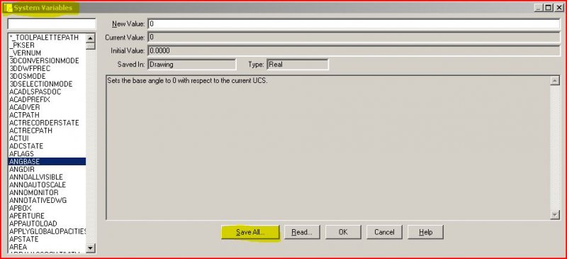

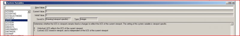

Dadgad Posted July 15, 2014 Share Posted July 15, 2014 (edited) Check out this snippet from the SYSVDLG regarding UCSVP, might be the variable you are after. NOTE that it is VIEWPORT SPECIFIC. I hope that helps you. Or might you just want to set your UCSFOLLOW variable to 1? It is always a good idea to keep a current .SVF (System Variable File) for safe keeping. To create one, at the bottom of the SYSVDLG box, choose SAVE ALL, as insurance against just such an inevitability, a system crash or other CADastrophy. In that way it is very easy to load, or restore your personal preferences on any machine. Edited July 15, 2014 by Dadgad Quote Link to comment Share on other sites More sharing options...

MorgaineDax Posted July 15, 2014 Author Share Posted July 15, 2014 Check out this snippet from the SYSVDLG regarding UCSVP, might be the variable you are after.NOTE that it is VIEWPORT SPECIFIC. I hope that helps you. I think this fixed it on my workstation; I'll see if it works for everyone else in the office. Thanks! Quote Link to comment Share on other sites More sharing options...
