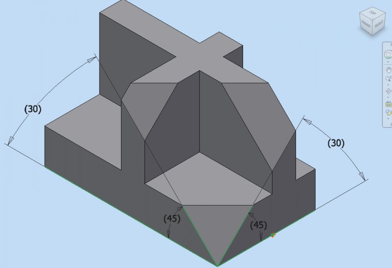

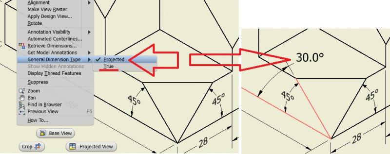

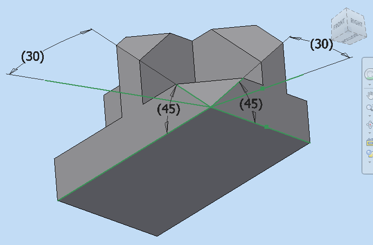

JD Mather Posted July 22, 2014 Posted July 22, 2014 (edited) Denimoth said: ... the 30° doesn't follow the plane of the geometry, but looks to be from the current view, ... The 84 was obviously wrong, wrong dimension and wrong location. Superimposing the image and using your tip on the origin of the 30° mistake - this is what I came up with as the probable design intent. A good reason to abandon isometric 2D drawing. Generate views from the single source of truth - the 3D model. Edited July 22, 2014 by JD Mather Quote

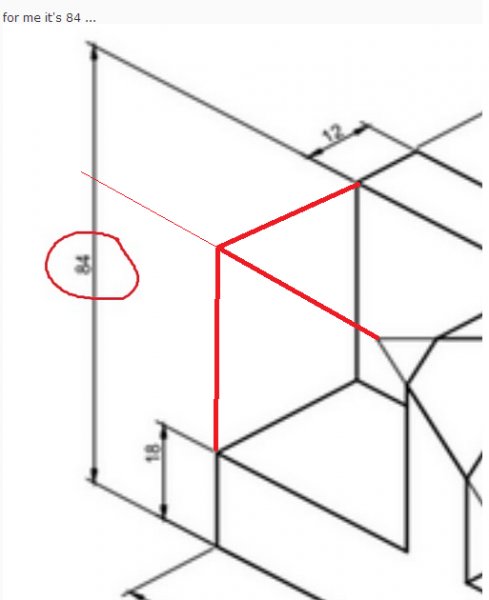

Titi95 Posted July 28, 2014 Posted July 28, 2014 JD Mather said: Where did you get this information? I looked at this thing pretty closely. Probably spent a couple of hours on it. I do not see a 64mm anywhere in the solution I suggested? I placed the image and superimposed my solution over your original image to reverse engineer the solution and used logic to figure out where the original designer made the mistake with the angle dimensions. for me it's 84 ... Quote

JD Mather Posted July 28, 2014 Posted July 28, 2014 Titi95 said: for me it's 84 ... Your "solution" is obviously wrong. 1. Those two points are not on the same plane - you cannot place a dimension between those two points in an isometric drawing. 2. It becomes obvious that your solution is incorrect when you compare to the original. If it is 84 for you - what is the distance shown here on the front plane of the part? See Post #17 for the source of that mistake. Quote

Titi95 Posted July 28, 2014 Posted July 28, 2014 JD Mather said: Your "solution" is obviously wrong. 1. Those two points are not on the same plane - you cannot place a dimension between those two points in an isometric drawing. 2. It becomes obvious that your solution is incorrect when you compare to the original. If it is 84 for you - what is the distance shown here on the front plane of the part? [ATTACH]50103[/ATTACH] See Post #17 for the source of that mistake. I was only confirming what is writing, but I also confirm that the coast is misplaced making the original plan must Quote

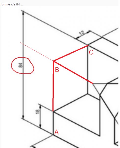

JD Mather Posted July 28, 2014 Posted July 28, 2014 (edited) CaddJax said: Which is the 'original' drawing? Back to the first post..... Yes, of course! Someone has a problem - you have to analyze the problem. You can't just say, "Well that is the information you gave me - I'm just going to push ahead. If my solution to your problem is wrong - it is because you gave me the wrong information." That is not how problems are solved - that only ensures failure to recognize and correct the problem. I will try one more time: Points A and B are in the same plane - so you can specify true dimension between these two points. Points A and B are on the Front plane. Points B and C are on the Top plane. Points B and C cannot be different heights? Points A and C are not in the same plane. This is a problem. You cannot ignore this first problem. Post #17 indicated the source of the error. Following the logic from Post #17 the source of the error in the angle made logical sense. Denimoth said: ... I can't really explain it, my french brain would explode trying to translate it to english....I can't explain it any better. Wish I could. Maybe someone else here can help with that. I've tried my best, if this doesn't work - I give up. Once the errors (and their sources) were identified - (unique) solution of the problem was fairly trivial. Using the scientific method - attempt to disprove the solution I offered. I am OK with that. I want to identify the correct solution. By what logic is it not correct? Edited July 28, 2014 by JD Mather Quote

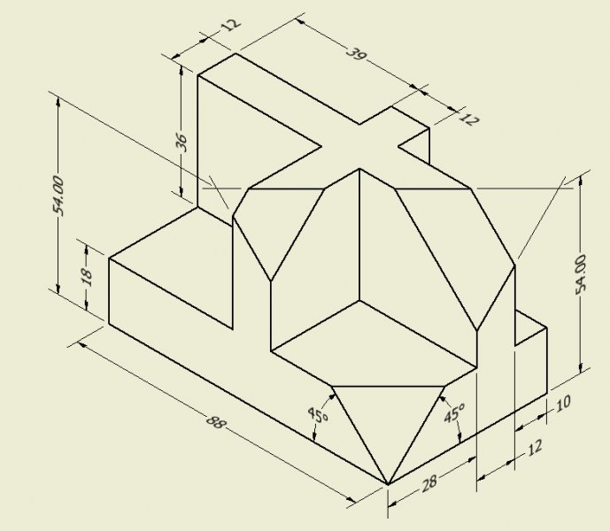

MinaRAI Posted July 29, 2014 Author Posted July 29, 2014 Hi guys, I finally found the same drawing exercise that I downloaded. I lost it somewhere but a friend had an old Acad 2000 book which had the same drawing. Here it is. As seen I have erred in drawing it. The total height is 56mm not 64mm(as I have said before). I did not check what I made and when I placed the dims it was 84mm. Wrong procedure. Do bear with a newbie please. Pardon me for the error and confusion. I misplaced the original cad exercise drawing and all I had left was the drawing print I plotted. All that was left was a vague memory. So sorry I do not have a desktop that's working also and i am just renting a pc in an internet cafe. All files are in a usb but I seem to have deleted it. Can't recover from the previous location where I started studying as they have problems there. More so they have DeepFreeze and the file may have been deleted already. So here it is guys. It took some time locating this drawing in google and youtube (from where I got it) to no avail. In connection with this may I ask again some elementary questions (please do bear with me). I am having problems drawing that triangle and subtracting it in 3D Model. What approach will I have to do it? I need to create that triangle and extrude it right? How can I position it to the 3D model? Move and paste it? If I use slice, how can I slice it? I do not know where to place the points so as to slice it at an angle of 45deg... As I am typing this one I also am trying to search for a video at youtube but could not find anything with a slice that would fit my problem... Thanks again Quote
Denimoth Posted July 29, 2014 Posted July 29, 2014 There is no need to draw and extrude a triangle to make the cut shown. SLICE is all you need. To determine where the point A is located, draw a line along the bottom front edge of the geometry, then use ROTATE3D. For ROTATE3D, I'd suggest you first try using the 2points option (or the "Z axis vector" in the drop down menu) pick point C for the first point selection, and pick the other end of the bottom edge at the back (where the 50 dimension is referenced). That will tell AutoCAD that you want your line to rotate along the axis you just defined. When it asks for the rotation value, type 45. Point A doesn't exactly need to align with the top projected edge for SLICE to work. Anywhere along the guideline you just drew and rotated will work. Now use SLICE, use the 3 points option, and pick the bottom corner (point C), the rear top corner (point B, you might have to draw extension lines to find that point) and anywhere along your guideline for your third point (equivalent to point A). When done, erase the excess solid and guideline. With AutoCAD, there are multiple ways of doing things that will get you the same results. You should also research how to change your UCS orientation to use the regular ROTATE command instead of ROTATE3D. This can be very useful when drawing 3D objects. Experiment with the options that UCS command offers, including the Face option. You can even pick 3 points to determine the origin, the direction of the X axis, and the direction of the Y axis. You're profile says you are using AutoCAD 2010. If so, check the help files and in the Contents tab, go to User's Guide > Create and Modify Objects > Use Precision Tools > Use Coordinates and Coordinate Systems (UCS) > Specify Workplanes in 3D (UCS), and read up on the information provided there to explain how to use UCS to be effective in 3D modelling. Quote
