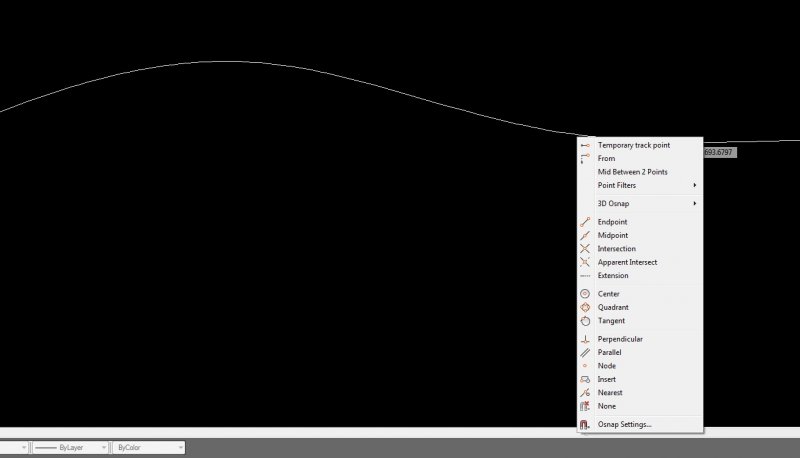

rock1 Posted July 9, 2014 Share Posted July 9, 2014 How can I draw lines which are tangential to an spline or an arc? I drew this manually just like that by intuition... Quote Link to comment Share on other sites More sharing options...
eldon Posted July 9, 2014 Share Posted July 9, 2014 Have you tried to use the Tangent Osnap? Quote Link to comment Share on other sites More sharing options...
rock1 Posted July 9, 2014 Author Share Posted July 9, 2014 Have you tried to use the Tangent Osnap? Yes, but that's for when I choose a point [say point Max payne] anywhere and draw a line from it, OSNAP detects the tangent on the spline so that the line drawn from the max payne point is tangential, what I want is I choose a point on the spline [that will become the tangent one] , then I make a line from that particular point Quote Link to comment Share on other sites More sharing options...

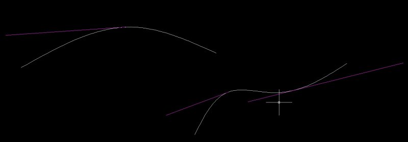

steven-g Posted July 9, 2014 Share Posted July 9, 2014 Try a block (line) with an alignment parameter. Then explode the block SplineTan.dwg Quote Link to comment Share on other sites More sharing options...
rock1 Posted July 9, 2014 Author Share Posted July 9, 2014 Try a block (line) with an alignment parameter. Then explode the block How did you do this? I downloaded the file, you've made the straight line a block. Then? I didn't understand what exactly are you doing. There must be a straight off method for this. some right clicking or pressing some key, I'm having a gut feeling. Quote Link to comment Share on other sites More sharing options...
steven-g Posted July 9, 2014 Share Posted July 9, 2014 Just a line, that is made into a block, then an alignment parameter placed at the centre of the line, thats it, the only alignment you can have on a curve is the tangent. Quote Link to comment Share on other sites More sharing options...
rock1 Posted July 9, 2014 Author Share Posted July 9, 2014 (edited) How are you using the align thing? I never use the align command. I use the rotate command then press R to align my objects. Can you post step by step screenshots? I used to work in an office where a guy told me to shift+right click on the spline and you can draw any where a perpendicular to it then a tangent, something like that. I drew a lot of RAYS form this command some years back..can't figure out Edited July 9, 2014 by rock1 photo upload Quote Link to comment Share on other sites More sharing options...
steven-g Posted July 9, 2014 Share Posted July 9, 2014 No commands, insert the block and drag it by the align grip (center of line) onto your spline it will align itself as you drag it around the spline Quote Link to comment Share on other sites More sharing options...

scj Posted July 10, 2014 Share Posted July 10, 2014 Hi rock1, attached is a LISP. Load it and start it by typing "ablpkt_vlax" at the command line. Then use OSNAP (for instance "Next" to define the point at the spline) and give a length for the tangent to draw. Good luck Regards Jochen ablpkt_vlax.lsp Quote Link to comment Share on other sites More sharing options...

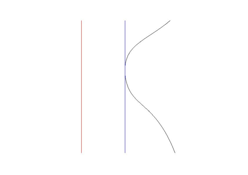

ivanchica Posted May 19, 2016 Share Posted May 19, 2016 Sorry, maybe I haven't explain myself good (don't speak english very well) The red one is a given line. Is there a way draw a tangent (blue) to a spline so that tangent is parallel to a given line? I have done this manually, but I was wondering is there a way to determine where exactly is the point on the spline in which that tangent touches the spline? Quote Link to comment Share on other sites More sharing options...
guran Posted May 19, 2016 Share Posted May 19, 2016 You can "FATTEN" the spline and thus converted to a polyline of arcs. Then draw a line from a selected arc center perpendicular to the given line. Quote Link to comment Share on other sites More sharing options...
