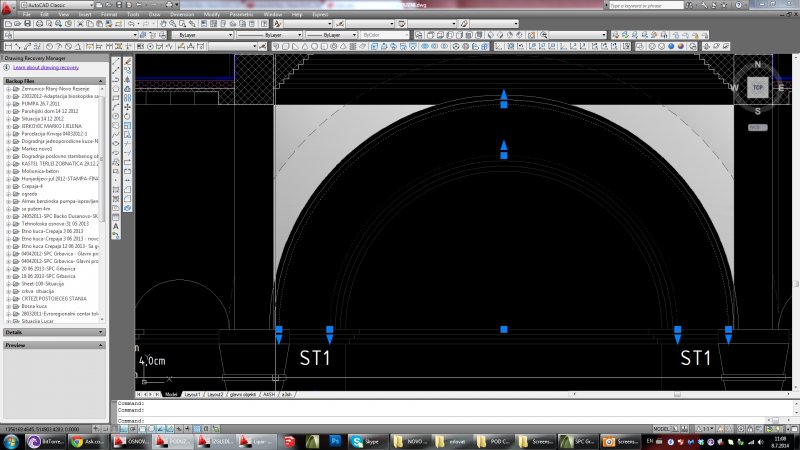

I need to apply a shape I drew to an arc.

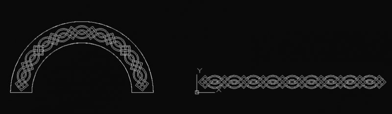

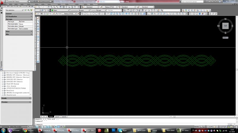

The shape is made of simple lines screenshot 1 and i would like to apply it to an arc-screenshot 2...I'm not sure if it can be bent?
To be easier to understand...i need an elevation of vault front which has a plaster relief on.

Wrap&Roll.dwg
Or, should the bending be like this?
