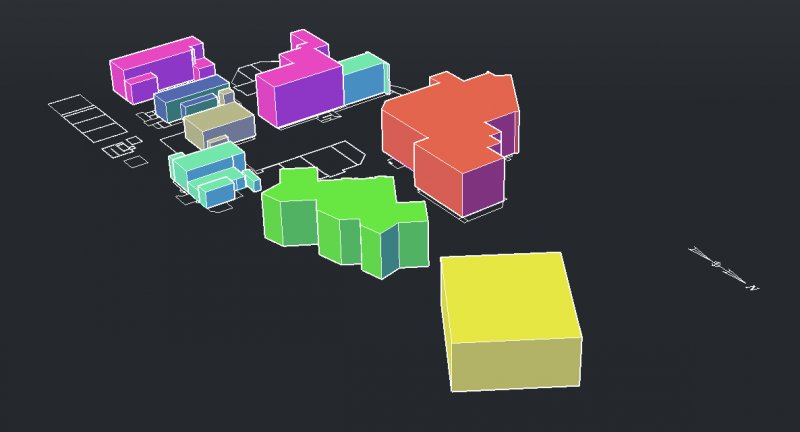

That could have been done in SketchUp although something similar could be done in CAD as well.
A hastily thrown together example using AutoCAD. Sorry but I didn't have anything that quite matched up to your example.
+1 on the SketchUp plug. One could do this in Blender (or any other general 3D program, Max, Maya, Lightwave, etc..) as well. Not as easy to do as in SketchUp but doable none the less. Anyway SketchUp Pro will allow you to bring in the DWG files and then sketch over them with 3D shapes and objects. You can apply textures or colors and set opacity as needed.
Very easy to do.

Looking at the picture again I would put money on it being from SketchUp.
