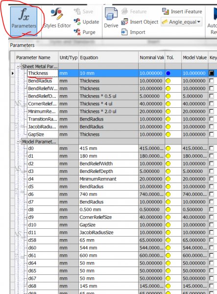

How do you define the thickness of the sheetmetal when creating a sheetmetal part? My text refers to a Thickness Parameter Value which I cannot find in Inventor 2015 Contour Flange.
I want to create this item in 10mm plate but I cannot even set it to 1mm sheetmetal. Is there any limit of sheetmetal thickness?
PB01-04-001 Press Frame.iptFetching info...
Have you gone through the Tutorials?
Also, all of the Parameters in you file are available at Manage>Parameters
