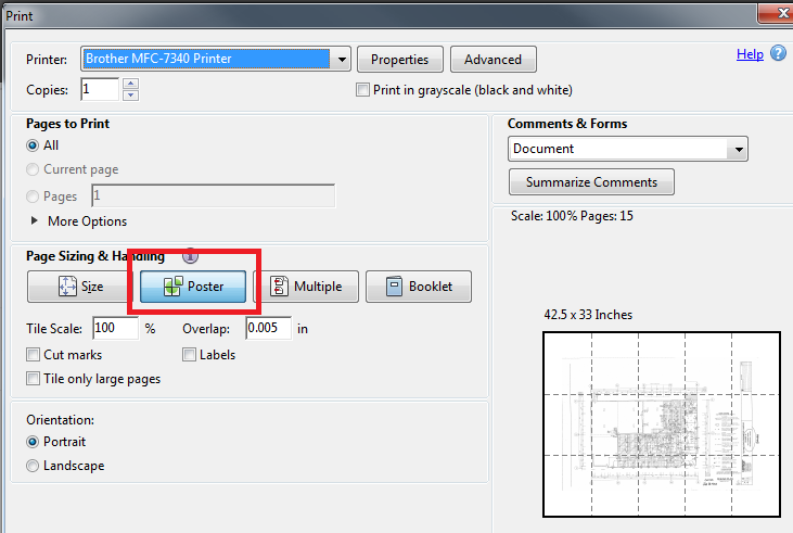

Number of steps used without any third party software.
1. Select correctly set up layout tab.
2. Type PLOT.
Adobe Reader XI has this capability built in. It's literally the only reason I have Adobe Reader still installed. See attached image:
