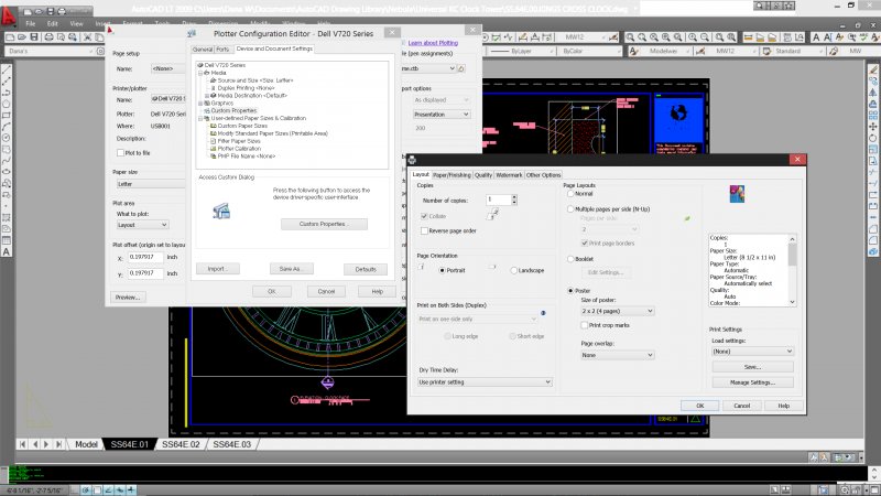

Dana W Posted July 2, 2014 Posted July 2, 2014 (edited) Apparently you have missed the availability of the Properties >> Custom Properties buttons in your page setup/plot dialog window. Look what happens (PNG attached below) when I click on them while having my bargain basement $139.00 Dell V725 printer (letter/legal only) hooked up as my plotter. You may have to save as... and zoom to see the dialog details. Straight from AutoCad 2009 LT with no monkey business right to a poster. I have not selected the proper poster size or layout orientation yet. I can also opt for crop (registration) marks or overlap distance. If you can't do this it is a failing of your printer, or lack of experience, not AutoCad. Let's see, I think a 24" x 36" landscape will probably require 3x4 sheets of letter size paper. Methinks there has been a tempest in a teapot. Speaking of tempests TS Arthur is raining on me. He's no biggie, but the last time a "No Biggie" went through Chuluota, she was named Tropical Storm Sandy. How can they build a Printer/Scanner/Fax/Copier and sell it so cheap you ask? By charging $13.00 per really small separate color ink cartridges, And by not building the scanner to work, that's how. Yes, that is the clock face at Kings Cross Station, at Diagon Alley. Edited July 2, 2014 by Dana W Quote

xelaris Posted July 2, 2014 Author Posted July 2, 2014 Dana W said: Apparently you have missed the availability of the Properties >> Custom Properties buttons in your page setup/plot dialog window. Look what happens (PNG attached below) when I click on them while having my bargain basement $139.00 Dell V725 printer (letter/legal only) hooked up as my plotter. You may have to save as... and zoom to see the dialog details. Straight from AutoCad 2009 LT with no monkey business right to a poster. I have not selected the proper poster size or layout orientation yet. I can also opt for crop (registration) marks or overlap distance. If you can't do this it is a failing of your printer, or lack of experience, not AutoCad. Let's see, I think a 24" x 36" landscape will probably require 3x4 sheets of letter size paper. Methinks there has been a tempest in a teapot. Speaking of tempests TS Arthur is raining on me. He's no biggie, but the last time a "No Biggie" went through Chuluota, she was named Tropical Storm Sandy. How can they build a Printer/Scanner/Fax/Copier and sell it so cheap you ask? By charging $13.00 per really small separate color ink cartridges, And by not building the scanner to work, that's how. Yes, that is the clock face at Kings Cross Station, at Diagon Alley. You are just spot on! I blame myself for being too lazy (internet and forums makes all a bit lazier nowadays isn't it?) - there is more than simply entering "poster printing" in the help search and pretending to find the right answer in one go. I've learned Autocad the old way - typing commands via keyboard - and happy with creative editing in 3D but plotting/printing has always been my achilles' heel - it was complex then (BI&BW = Before Internet and Before Windows)....now, it's scary. Thanks for pointing me in the right direction.... Quote
Dana W Posted July 2, 2014 Posted July 2, 2014 xelaris said: You are just spot on!I blame myself for being too lazy (internet and forums makes all a bit lazier nowadays isn't it?) - there is more than simply entering "poster printing" in the help search and pretending to find the right answer in one go. I've learned Autocad the old way - typing commands via keyboard - and happy with creative editing in 3D but plotting/printing has always been my achilles' heel - it was complex then (BI&BW = Before Internet and Before Windows)....now, it's scary. Thanks for pointing me in the right direction.... Glad we could help. I am not surprised so many other people have missed this too. After all AutoCad is first and foremost an engineering and design software that is geared mostly to large format printers. The big stuff is right up front where it is almost automatic to use that way. It is usually the small timers like me, who have been forced to deal with letter sized printers because the large format ones cost more than my car. Normally, I supply clients with pdf's, not even printed, but occasionally I need to make a poster for a full sized page in order to check the final output or to make a redline for myself. Quote

xelaris Posted July 4, 2014 Author Posted July 4, 2014 This is a quick update to my recent finding from some of the suggestions offered in this thread... Unfortunately the suggestion coming from Dana doesn't work in my case - let's bear in mind that it might still be the case of me not being experienced enough with the plotting/printing features of Autocad....but when entering the Custom Settings one is allowed to enter any paper size (even bigger than the maximum allowed by the printer) e.g. if one sets the printer to "none" or one of those virtual printers which output a PDF (file not actual paper)...in such cases, yes, the options seems all there...but then when I select my printer for printing (a Canon MP610) then I get an error message saying I'm not allowed to use that paper size?! (that's because Autocad doesn't know my Canon can print in Poster Mode)....so, I have to resort to save in some other file formats (e.g. PDF) and then opening another application which can communicate better with my Canon e.g. ignore paper limitations - just send the bxxxxy file to that fxxxxxg printer!!! I was a bit suspicious that our friend in Russia has to come up with a separate plug-in to address this very annoying issue....some users are maybe luckier than other and use a printer which is fully recognized by Autocad - mine isn't (apparently). Quote
Dana W Posted July 5, 2014 Posted July 5, 2014 xelaris said: This is a quick update to my recent finding from some of the suggestions offered in this thread...Unfortunately the suggestion coming from Dana doesn't work in my case - let's bear in mind that it might still be the case of me not being experienced enough with the plotting/printing features of Autocad....but when entering the Custom Settings one is allowed to enter any paper size (even bigger than the maximum allowed by the printer) e.g. if one sets the printer to "none" or one of those virtual printers which output a PDF (file not actual paper)...in such cases, yes, the options seems all there...but then when I select my printer for printing (a Canon MP610) then I get an error message saying I'm not allowed to use that paper size?! (that's because Autocad doesn't know my Canon can print in Poster Mode)....so, I have to resort to save in some other file formats (e.g. PDF) and then opening another application which can communicate better with my Canon e.g. ignore paper limitations - just send the bxxxxy file to that fxxxxxg printer!!! I was a bit suspicious that our friend in Russia has to come up with a separate plug-in to address this very annoying issue....some users are maybe luckier than other and use a printer which is fully recognized by Autocad - mine isn't (apparently). Does it work for the 8 1/2" x 11" paper? That is the only way I can get mine to work from AutoCad. How about a driver update for the printer. Might work, if there is one available. At least Arthur hasn't done a lot of damage like Sandy did. Quote
