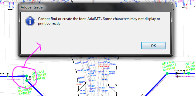

publish pdf. text problem how can i fix it ...?
check this jpg publish pdf done after open pdf file come this window and some text not come its come **** like this how can solve this problem please help me

The message seems to imply that the required font cannot be found. Find, download and install it and see if that fixes the problem.
Hi
Seems to be a common problem with the Autodesk DWG to PDF plotter driver (see numerous posts on the subject). Simple fix is to change the configuration under Properties/Custom Properties and change the Font Handling setting to Capture All.
Microsoft apparently hasn't supplied Ariel MT for years. It doesn't exist on my Win 7 or Win 8 machines.
