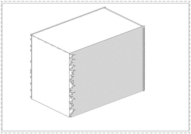

I'm having issues with the 3D Hidden Visual Style of some of my 3D models. There is no issue in the early stages of the drawing but after a while the model becomes corrupt & starts showing parts of the model that should be hidden.
Attached is a screen shot of this issue in AutoCad 2007.
I've also attached a screenshot of the same file opened in a colleagues AutoCad 2010 version (same spec CPU) which gives perfect results.

Same spec PC? Does this include the video card/driver version? Is Hardware Acceleration enabled on both?
I've observed 3D hidden to be more demanding on the graphics system than other 3D visual styles....
Yes - it has the same video card/driver version.
I have enabled Hardware Acceleration & this has improved the quality significantly which is great thanks (see attached).
But with the Hardware Acceleration enabled I now get weird things happening in the model space when moving the curser around (see attached). Not sure what’s going on here???
