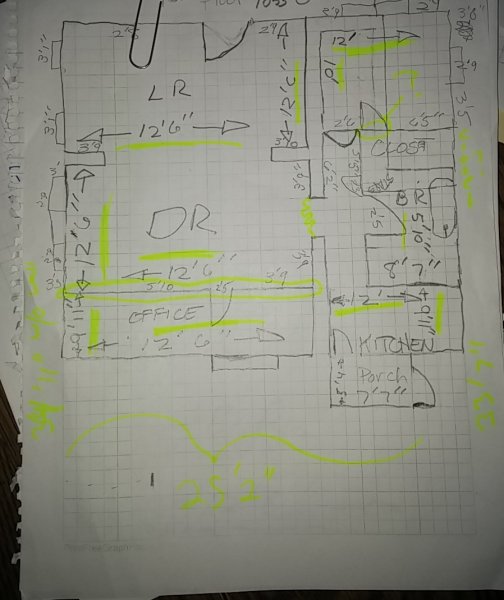

jwalkeroh Posted June 28, 2014 Posted June 28, 2014 OK, so i have 8 houses with 3 floors a piece that I need to draft up in cad. The guy who took the measurements gave me 24 sketches of 24 floors that look like this. . . The problem is that when I add up all of the measurments on adjacent walls, they are different. How can I make something that is supposed to be a rectangular object in cad when walls are different specs? Its hard to see in the picture. Does anybody know what I mean? Have you ever had to draft something that doesnt add up logically? Is there an option in cad to make a lopsided house?????? The left side is 34'11'' and the right side is 33'7'' ideas? Quote
Cad64 Posted June 28, 2014 Posted June 28, 2014 It's really hard to read all that, but if you truly feel the measurements are incorrect, contact the guy who gave them to you and ask him to verify the dimensions. Quote

Dana W Posted June 28, 2014 Posted June 28, 2014 They are pretty bad, but I have seen field dimension sheets that make those look like Michelangelo did them. I drew a huge condo remodel last year where they would knock down a wall right after I drew it on the plans, several times. Design change. Are they As-builts? I don't see any wall thicknesses. That may account for the differences. Somewhere on one side, there are plumbing walls that are much thicker than the normal partition walls. I'd say the sketches are pretty unprofessional. Without wall thicknesses the drawings are incomplete. Before you start, make it known to whoever provided those drawings, what the deficiencies are. The last thing you want to do is work in these for a couple of weeks before that person is informed of what you are dealing with. Don't be confrontational, (but I guess you know that) just say there seems to be some missing dimensions you could use further verification on. The living-room/dining room side seems pretty straightforward. I'd use that as my starting point, and work to it. You may want to draw each room separately and then bring them together, sorta like a puzzle. That may help you find where the Wet Walls and HVAC chases are. Expect to find thicker walls between the bathrooms, kitchens, and adjacent walls, and the closets and stairs. Those are all likely places to run pipes and ducts up through. I don't know where you are, but here in the U.S. stairs are a minimum of 37" wide finish to finish, and closets are a minimum of 25" deep fin. to fin. A typical interior partition is made of 2x4's which are 3 1/2" wide, then allow at least 5/8" of drywall on both sides, totaling 4 3/4". Somebody will have to tell you how thick the exterior walls are, they vary too much depending on materials. Yeah, I know, drywall is usually 1/2" thick, but walls are bumpy, studs have crowns. It is entirely possible that one side is longer than the other, if there is a vertical break in the elevation, but I can only guess. I see the windows and doors are not located either. Let us know how it goes along. Feel free to ask more questions, and for more advice. Oh, and welcome to the forum. You will like it here. Quote

Dana W Posted June 28, 2014 Posted June 28, 2014 ALSO Im downloading autodesk architecture. Is this easier to use for floorplans than basic CAD? I've often wondered how draftsmen get to simply go off and download software like this. The answer is yes it is easier to draw houses with, but much harder to learn, and the software is wasted on simple residential houses. Stick with AutoCad. Walls are rectangles with the overlapping ends trimmed and then joined. Quote
