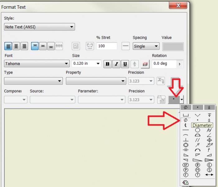

2. How can I add diameter symbol to my text
2. Text symbols are found here (see image) or type Alt 0126 Ø (must use the numerical keypad, not the number row at top of keyboard)
