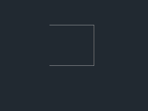

Yes, you have to be zoomed enough to be able to tell what your aperture is over and closest to. You can literally have hundreds or thousands of Snap points inside the aperture in a busy drawing. In the following animation, I made the Aperture visible during selection to demonstrate that only objects within the Aperture get searched for possible OSnap points. If the aperture is not over the dimension, there's zero chance it will snap to the extension line.
Also keep in mind that you don't need to have the crosshair at the point you want to start the line, AutoCAD only needs to have acquired the OSnap point. This allows you to reduce the number of objects within the Aperture, and snap to exactly the intended point even when there are many coincident OSnap points.

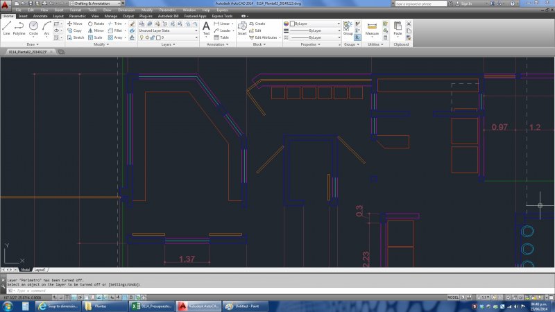

Very illustrative and clear. I guess I should zoom in a bit more to avoid snapping to the dimension line. I wanted to draw a perimeter at the zoom level shown below. You can see several dimension lines close to the corners. No objects or lines should be able to snap to dimension lines, though.There should be a setting that prevents or turns off snaps to dimensions. It could result in a total mess. Frustrating.
