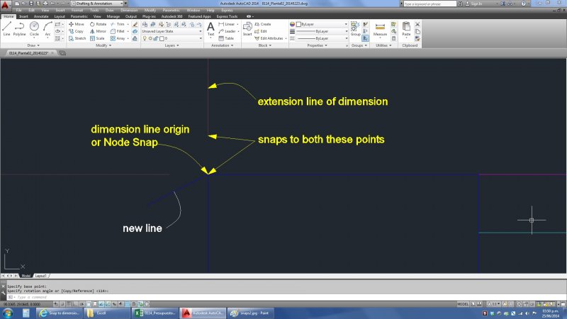

yayingo Posted June 25, 2014 Posted June 25, 2014 Hi people, I need help regarding the snaps command. Im trying to start a line from the basepoint (the point where the dimension line is anchored to) of a dimension line. However when I want to start the line I get 2 snap points, the actual basepoint (node snap) and the endpoint of the extension line. When the drawing is zoomed out where i can see the entire plan, it snaps to the endpoint (Which i dont want to) and i have to zoom way into the detail to grab the snap i want. It makes it to complex to zoom out and in again everytime. TUrning the Dimensions layer could be an option, however i would like to know if there is a satting to prevent this. The extension lines of the dimensions must be offset, so extending the line to its basepoint is not an option. Disabling the Endpoint snap is not going to work either, since i need that snap. I tried to be as clear as possible. If not, let me know how to fix this. I dont want snaps to the extension lines of my dimensions. Quote

yayingo Posted June 25, 2014 Author Posted June 25, 2014 Thanks all for your comments. I dont really want to start a line from a node. I want to start a line from a corner in my drawing, which happens to have a dimension line. The extension line from the dimension line starts on the corner of my geometry. Whenever i start the line command, i want my line to start from the same corner on my drawing, but it snaps to the end of the extension line of the dimension line (which is offset from origin) AND the corner itself (node snap), depending on how zoomed in I am into my drawing and where i have the crosshair. Sorry if it is a little confusing, trying to type as clear as possible. Quote
yayingo Posted June 25, 2014 Author Posted June 25, 2014 Disabling Node snap doesnt work either. It snaps to both (geometry corner and end of dimension extension line) as Endpoint snap. Quote

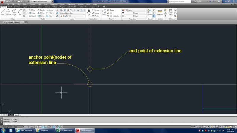

yayingo Posted June 25, 2014 Author Posted June 25, 2014 Another sketch to try to make it clearer. Quote
nestly Posted June 25, 2014 Posted June 25, 2014 It can only be "snapped" to one at a time, in your case, either the endpoint at the corner, or the "endpoint" of the extension line. Are you familiar with the Aperture? --> Link Quote
yayingo Posted June 25, 2014 Author Posted June 25, 2014 I realize it snaps to one at a time, but when the drawing is zoomed out, i cant tell wheter it snaps to the Endpoint of my geometry or to the Endpoint of the extension line. For accuracy matters, i would have to zoom all the way in at every point associated with a dimension line. Let me check the link. Thanks for your reply Quote
