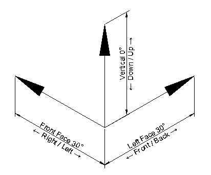

Depends what you're drawing. 3 major types of drawings:
  1. Orthogonal (Plan / Elevation / Section) - angle would be "from top" = Plan, "from side (left/right/front/back)" = Elevation/Section. Refer to Remark's answer for more detail regarding this. These would then be analogous to the angle-of-projection. http://www.technologystudent.com/designpro/ortho1.htm
  2. Isometric - a view skew-on to the 3D model. Also referred to a oblique. The normal way would be as this capture_06242014_085702.gif
