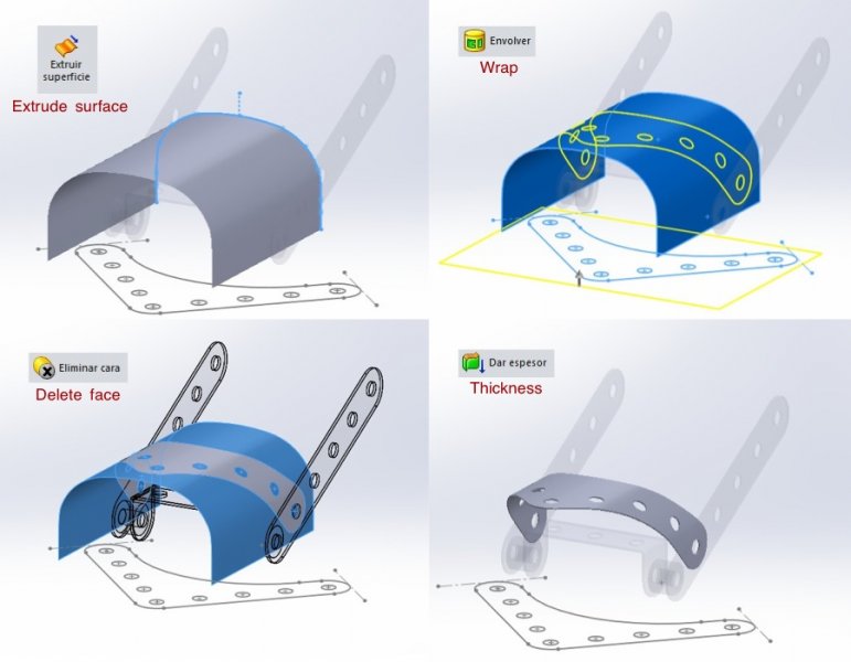

diegsn Posted June 21, 2014 Posted June 21, 2014 Hello, I would like to bend a flexible piece like that. I have used the Flex tool but the result is very imprecise. What tool or method you can suggest to me? Thanks Ensamblaje flex L (intento).zipFetching info... Quote
stevsmith Posted July 4, 2014 Posted July 4, 2014 You should use the sheet metal tool for this as opposed to solid modelling. Draw out the contour, add material thickness, unfold and trim out the "v" shape then fold back to the original shape. (sorry for the poor example, I only had a few minutes to do it) Quote
diegsn Posted July 5, 2014 Author Posted July 5, 2014 Thank you very much, I will try to do it like you say For this example I finally use the Wrap tool, but this method is not useful for other pieces Quote
