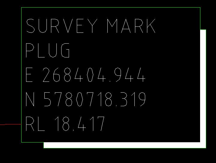

I need to know the easiest way in which I can drag a label box automatically with coordinates of the points appearing in the box? I am using Civil 3D Cad
You require a style that is what you want then you can grip and drag etc I will see if I can pull this one out of our set. Styles are a pain lots of info.
