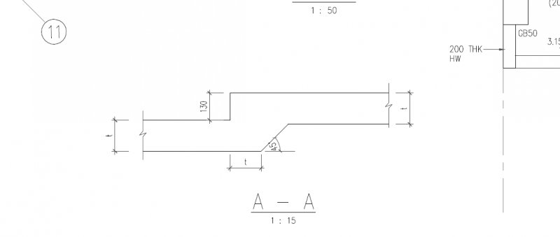

James7s Posted June 19, 2014 Share Posted June 19, 2014 Hey guys, I am very new to AutoCAD-MEP, and I am actually not using it at all. I am looking into switching from Vanilla AutoCAD (2D Drawing) to MEP in next project, and I am now assuming I was using MEP in my current project (by Try-and-error) to familiar with it before dealing with a real project. But I am now facing a problem, I know that I could used "Structural Member Style Wizard" to create difference size of "Beam" object, and add it into drawing with "Beamadd" Command. But, When I look into the structural details sheet in my project, the structural engineer have created a lot more wrie-shaped beam. for example: Cranked Beam I know that, If I "have to" make it, I would draw 3 beam object to "simulate" a solid beam like that.(if a silly method works, then it is a good method). But, during my current project, the Architect just keep moving the wall, partition line and even the floor level(about twice a month, average) and the Structural engineer keep changing size of beam even few days before concreted(OMG how they could do that?), I would better to find a method to create section and analysis the consequence (In terms of MEP Service) of such changes in a very short time. I wonder if I could create a crank beam or a cranked slab object? Quote Link to comment Share on other sites More sharing options...

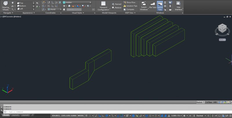

James7s Posted June 19, 2014 Author Share Posted June 19, 2014 OK, by Now, I Know that I am able to make the Crank Beam by 3section: a Normal Beam, a Crank Beam Style and another Normal Beam. This Sound silly and quite "Not BIM style", but at least It works... But I quite wonder, Let say, In a project, I have 6 style of Beam, 100x200 RC Beam, 100x300 RC Beam, 100x400 RC Beam, 200x200 RC Beam, 200x300 RC Beam, 200x400 RC Beam. so, I have to create 6 type of styles for each type of beam Can I just create a Style Called "WxD RC Beam" and leaving W and D as a custom parameter for me to input? It seems to be quite time consuming if I create a style when I needed. in 2D dynamic Block, I could easily do this, but it seems like I have to create a hundred of styles to cater every single small changes in a drawing Quote Link to comment Share on other sites More sharing options...

KeithBrown Posted June 25, 2014 Share Posted June 25, 2014 [ATTACH=CONFIG]49570[/ATTACH] It seems to be quite time consuming if I create a style when I needed. in 2D dynamic Block, I could easily do this, but it seems like I have to create a hundred of styles to cater every single small changes in a drawing Just create your beam as a parametric mvpart. You can then modify the parameters how ever you want and do not have to be tied down to a specific style. Quote Link to comment Share on other sites More sharing options...
